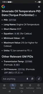

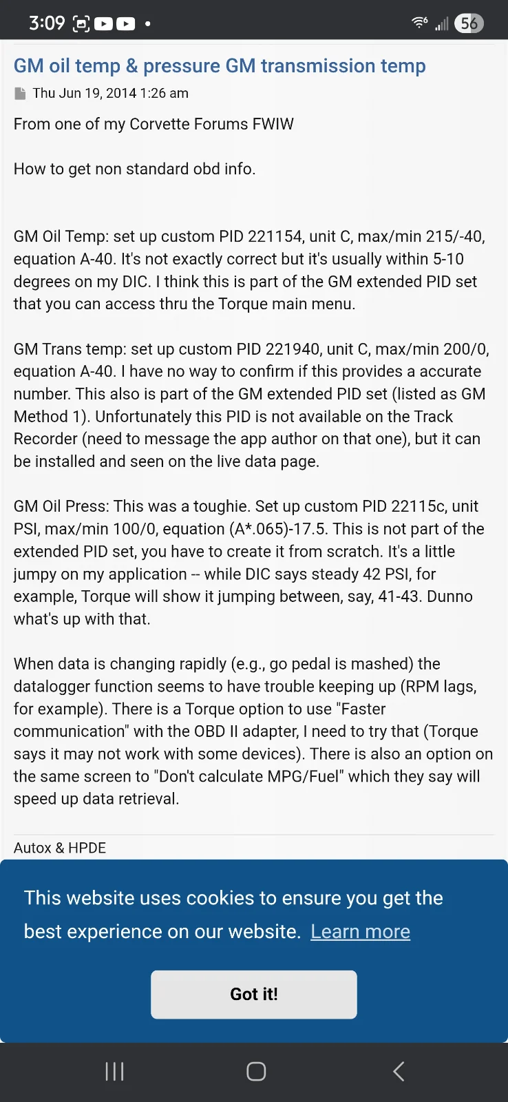

Some comments said this didn't work with all readers.

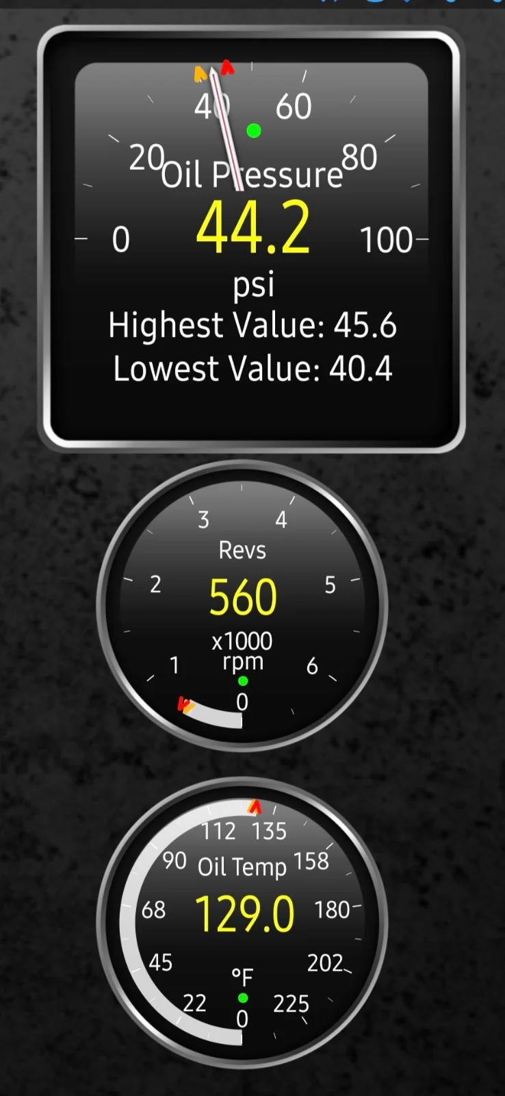

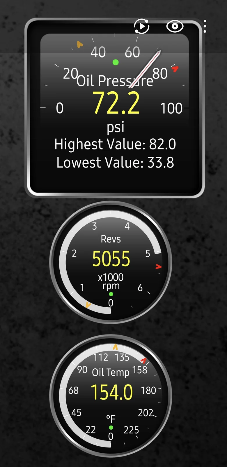

That PID worked on my Torque Pro App. Seemed to respond once I started driving, i only drove about 5 miles. I banged some gears for a couple miles and got it up to 160F, but it dropped fast when I coasted in to the house.
Measured the oil pan temp and got some similar readings, but they were really inconsistent. I dont think it liked the shiny aluminum surface. Probably radiant heat from adjacent equipment too.
