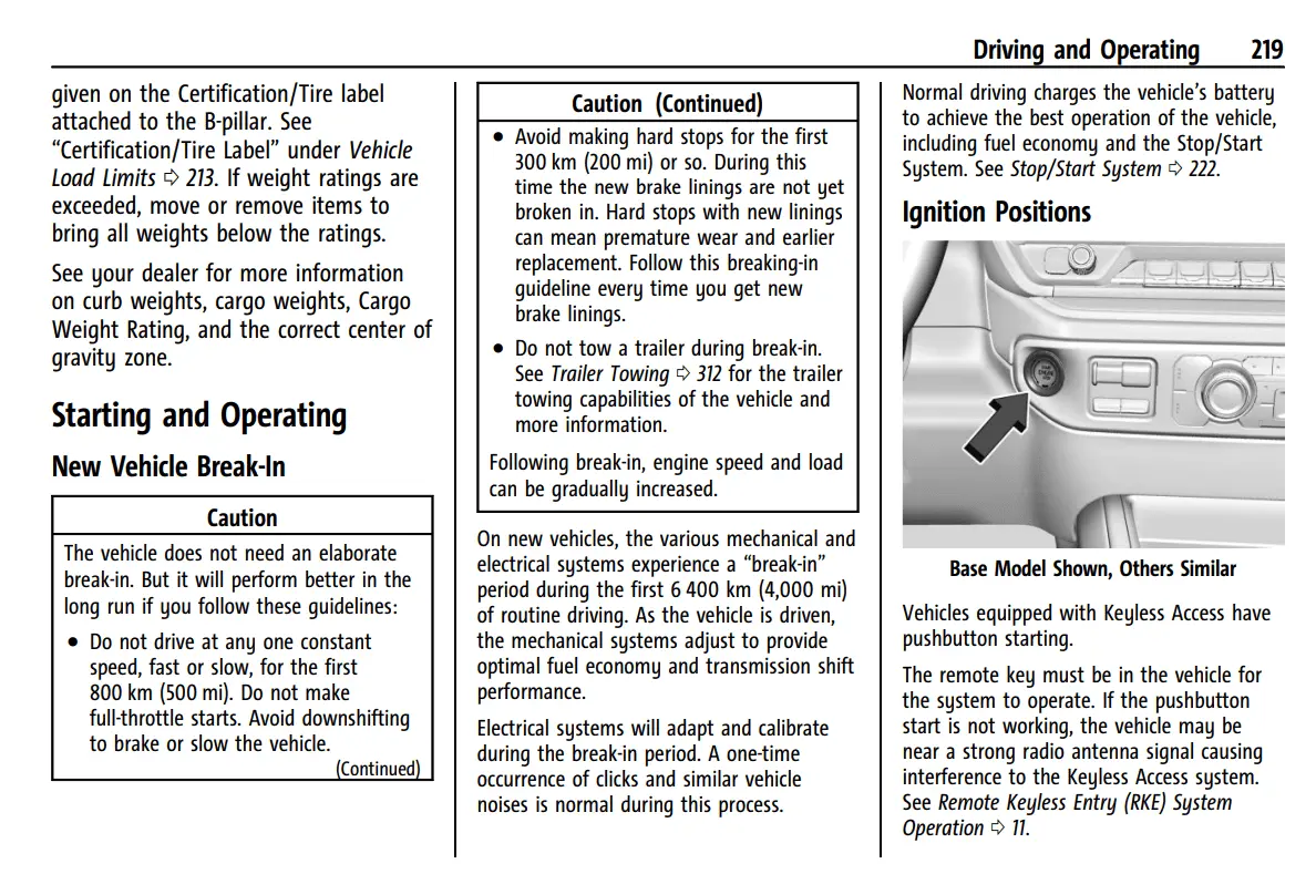

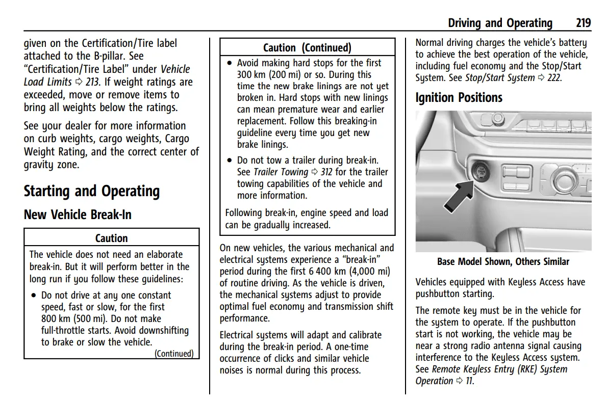

... I too pickup my ZR2 tomorrow, Friday. As far as break-in period, going to do the traditional route to be safe.
Here's what I found from page 219...
So I'm assuming making a 60 mile trip on the interstate right out of the dealership is a no go?
That's going to be the hardest part. How to keep the speed fluctuating while bringing her home. I have to go down a highway too, looks like it is back roads for folks like us.
Just put it in L and use the paddle shifters to fluctuate the rpm's every so often. Remember it's not vehicle speed, but engine speed....rpm's.
Just put it in L and use the paddle shifters to fluctuate the rpm's every so often. Remember it's not vehicle speed, but engine speed... rpm's.
Is that safe to do though? It also says in the manual to avoid downshifting.
Yes, with a 10 speed transmission you can cycle through 8-10 without significantly slowing down. The manual is talking about using it in the lower gears to slow the vehicle down, instead or along with the brakes. Like if you were towing or hauling a heavy load and using the transmission as an engine brake.
Ah I gotcha, kk perfect, thank you for the tip!!
