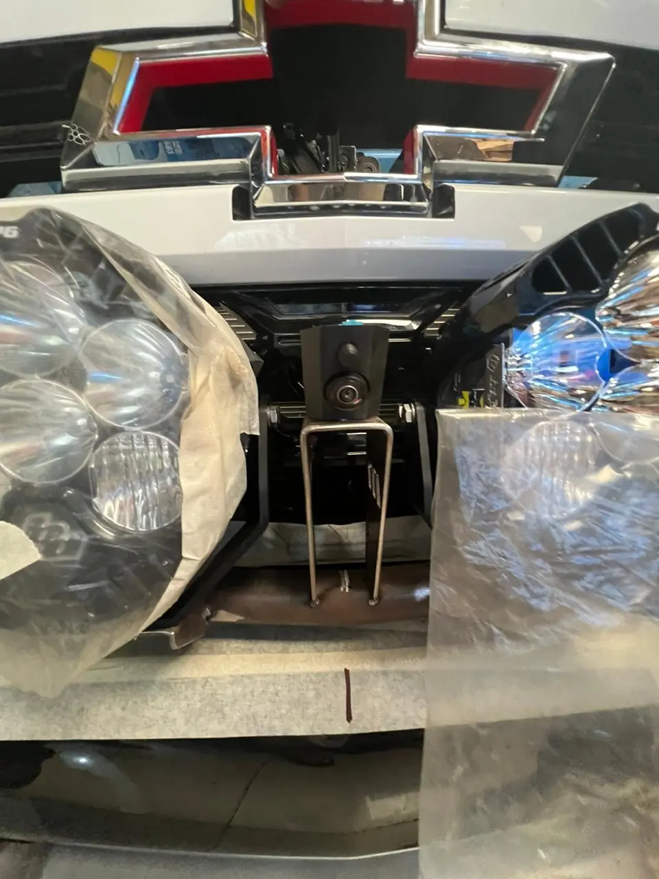

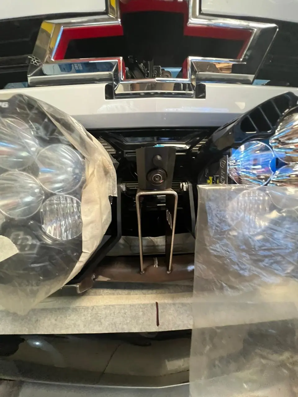

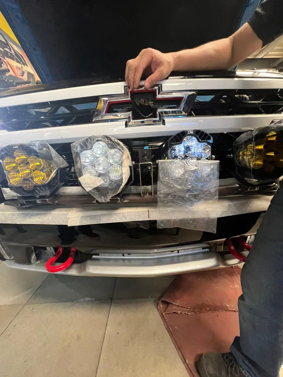

Hi All,
wanted to add this here on a mod I did for my truck to relocate the front camera since I'm having front auxiliary lights installed.
I will be installing front auxiliary lights that might block the view of the front camera, I needed to find a solution to avoid an issues with my front camera view being obstructed or blocked and I couldn't seem to find anything online for our Silverado platform.

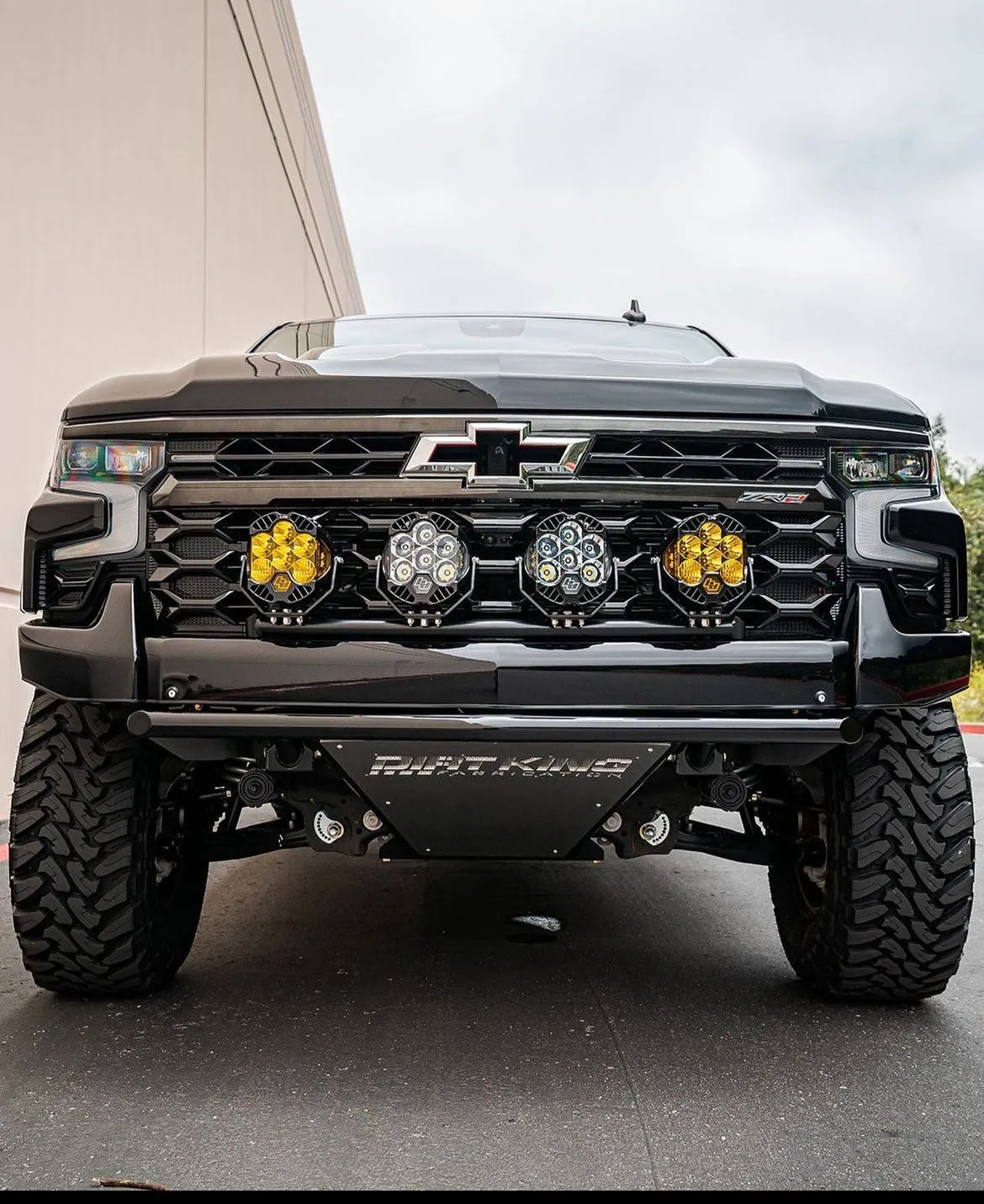

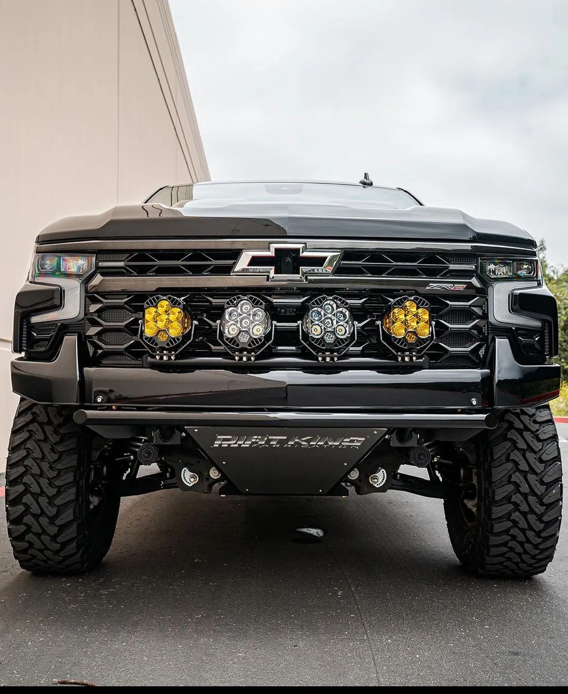

Just to give you an idea how my light set up will be the inspiration is from Dirt Kings Instagram page, bellow image
I did manage to get in touch with the owner of the truck and he did mention the lights to obstruct the front camera view only on the left and the right sides of the truck but has no issue with the front, which isnt something i would frankly be comfortable with.

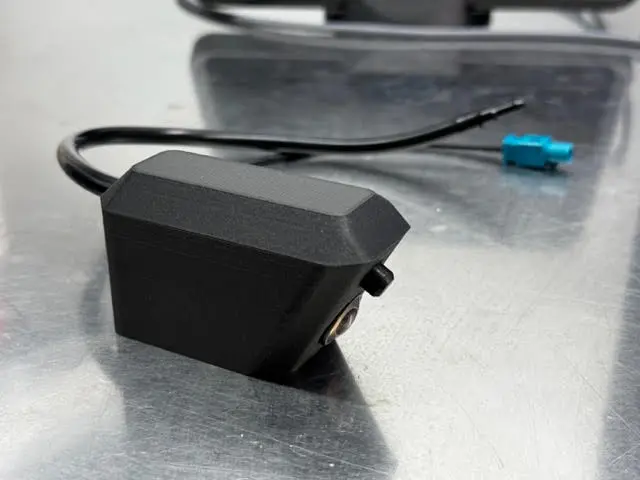

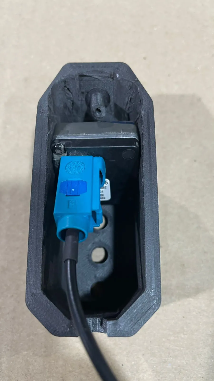

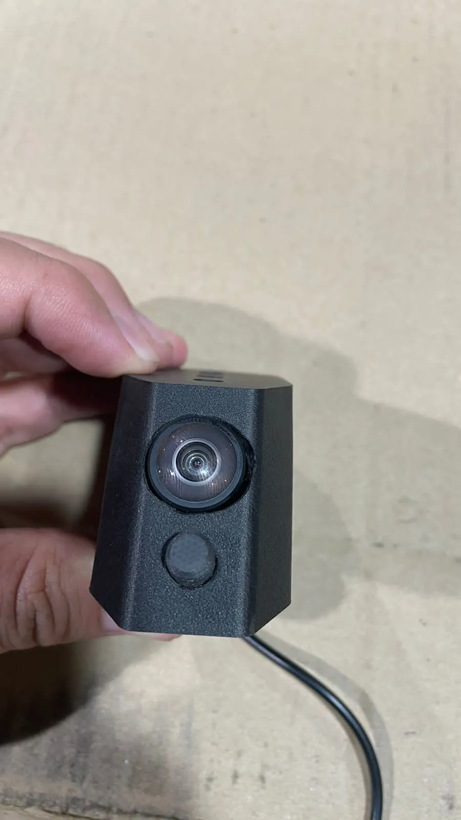

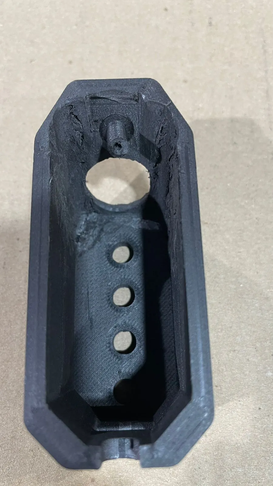

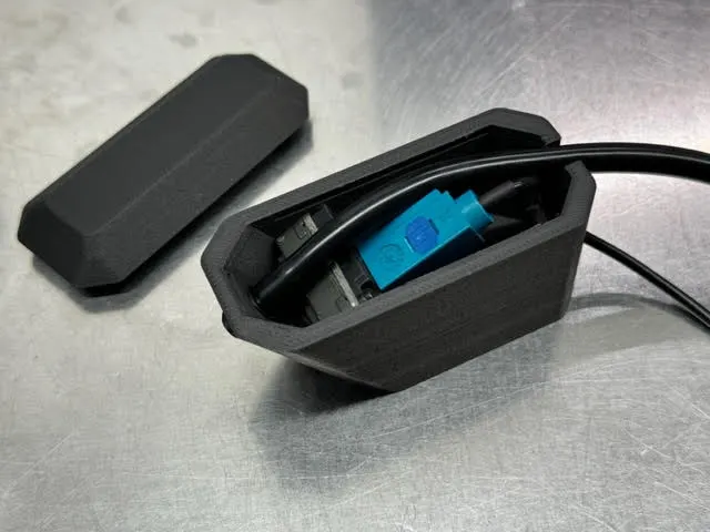

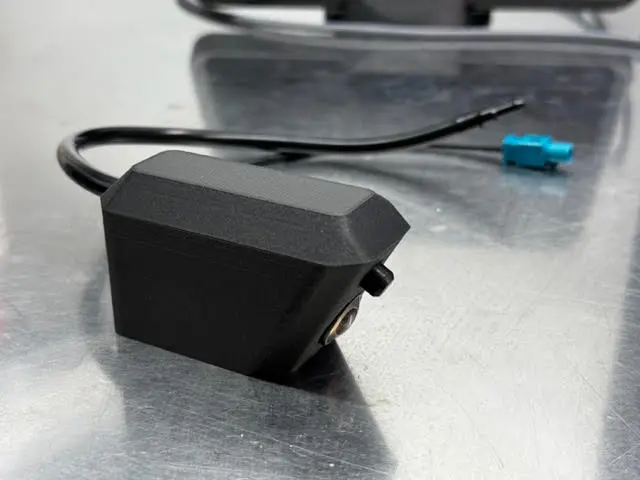

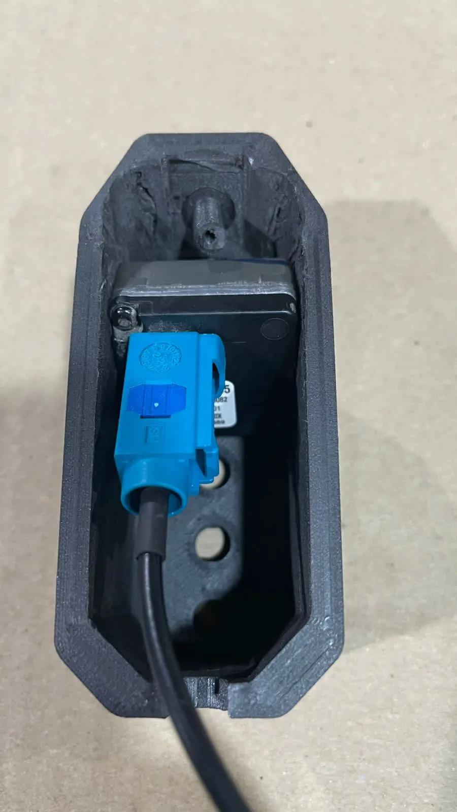

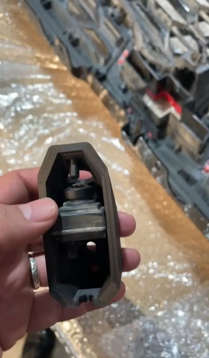

As you can see they offer an extension wire for the camera along with the housing, I did end up ordering this and decided to try my luck with it, I did face some implications but luckily the camera wire in the kit is compatible with our cameras but the housing needs to be modified, interestingly our cameras are much larger than the ones on the ford raptor (very ironic for a very expensive truck like the ford raptor having a smaller camera)

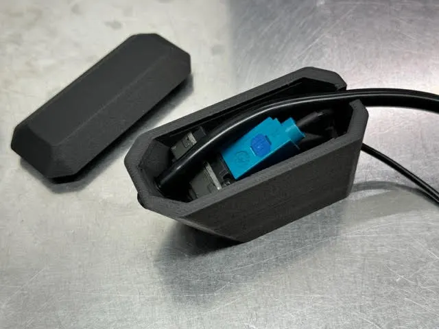

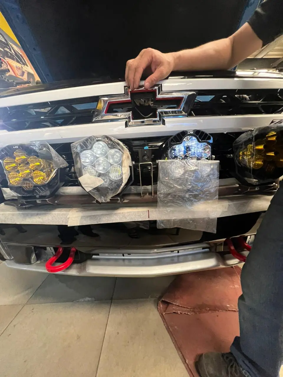

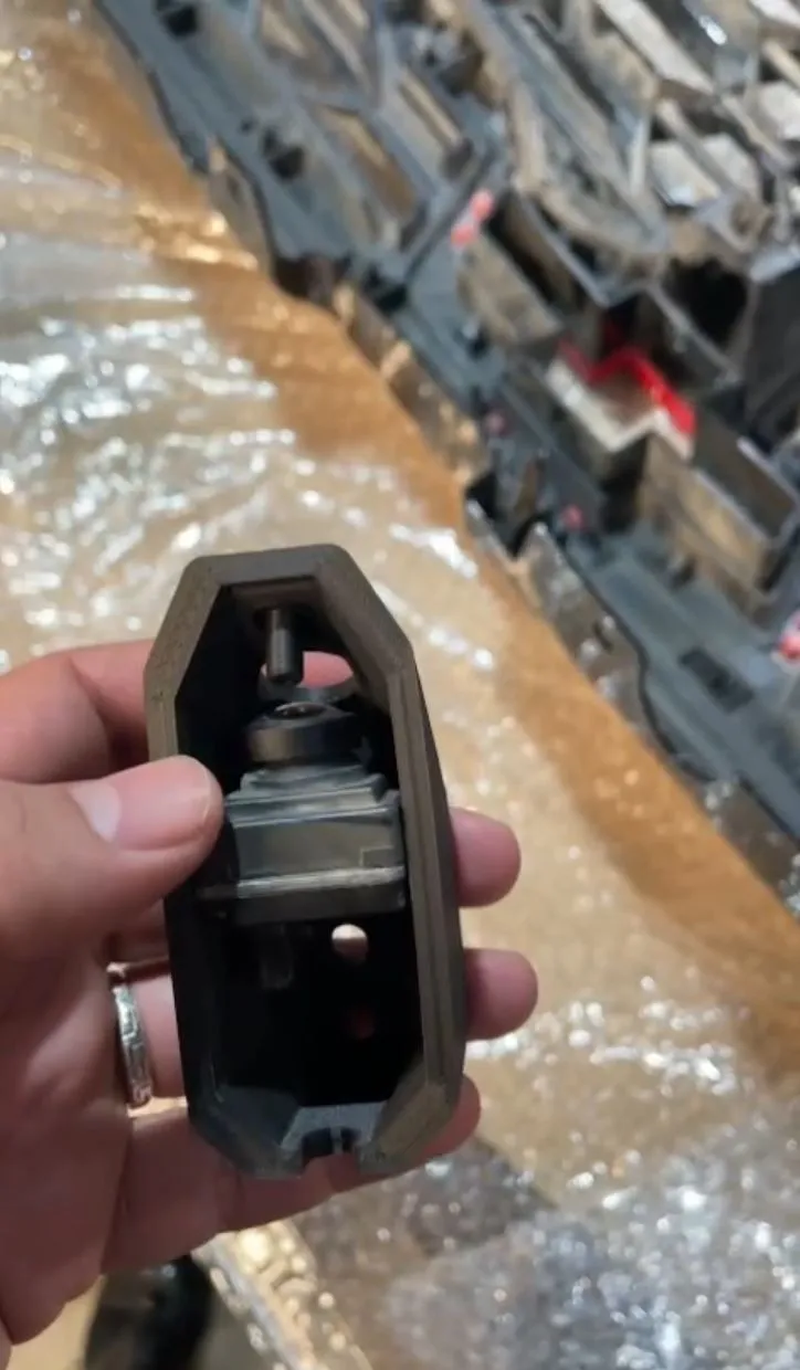

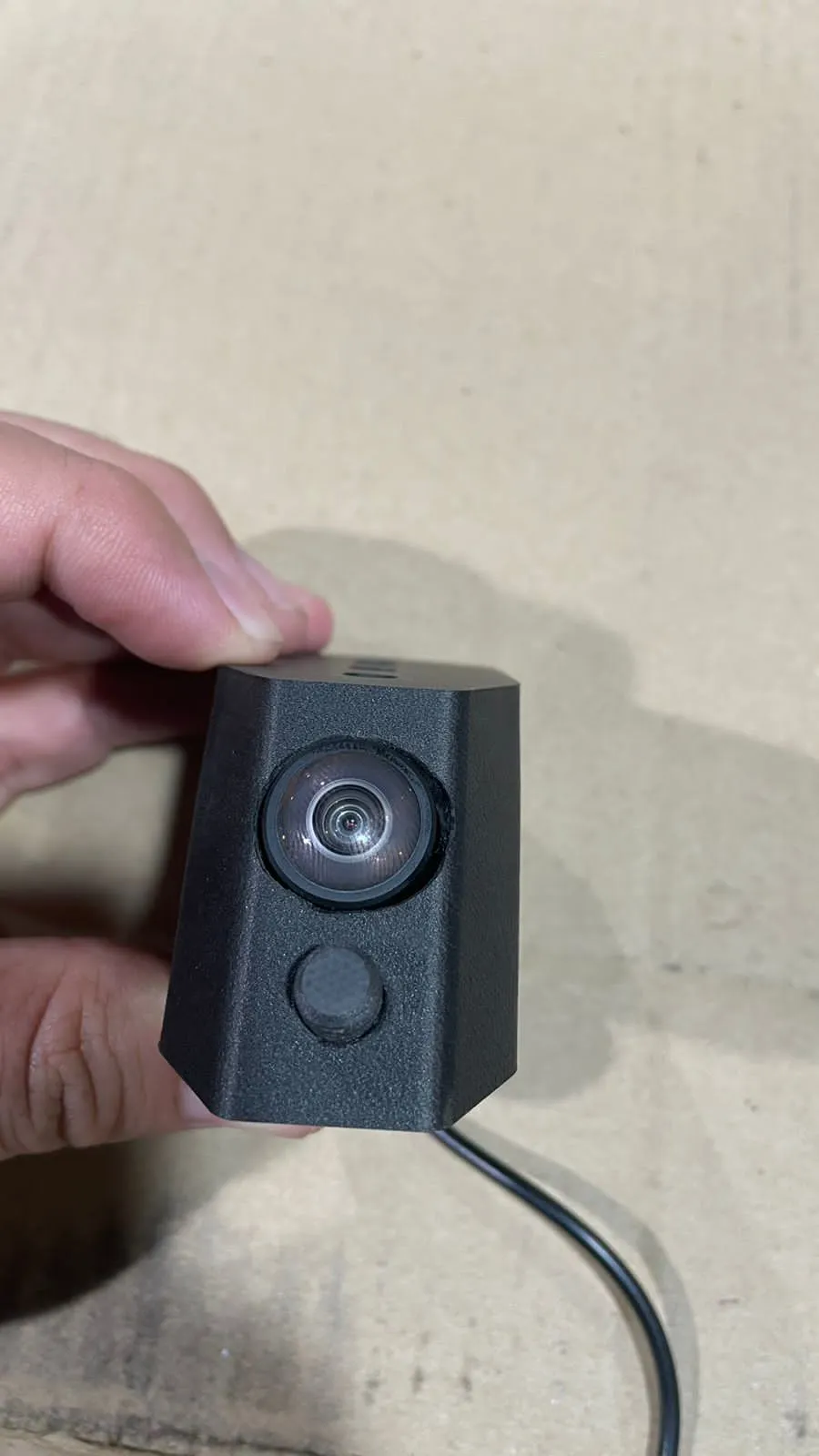

bellow images for a before and after trimming of the camera housing to accommodate my camera into it.
Please note you will have to also trim the diameter of the camera hole to accommodate the bigger lense of the camera if you plan on doing something like this.
If anybody has managed to do anything better please do share, I don't know if I will be permanently sticking this since this housing is actually 3D printed and I would honestly prefer a metal housing for the camera. but overall frankly I'm satisfied with this.
got an update on this, contacted Nine volt the company that developed the camera relocation kit for the raptor.
We should be expecting a relocation kit soon for the Silverado ZR2 in the coming weeks as it is being developed now glad to be part of working with them and giving them insight on my mod and overall feedback of fitment!
View attachment 7704View attachment 7705View attachment 7706View attachment 7707
Very cool option. I would also be looking forward for the rear view mirror and reverse camera relocation kit when available. RTT on bed and bicycle stand on hitch receiver hides those views and is frustrating.
Also something that caught my eye is the front bash/skid plate. Looks cool. Any additional information on that skid plates and bull bar? It does look like some trimming is involved too.
Hey, for the front I just added a light bar, a local shop here in Dubai did the Fab work for me
