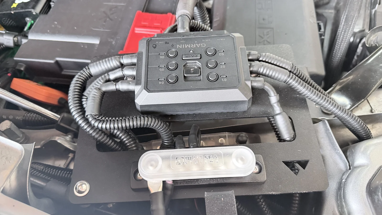

Installed a Garmin Power Switch back by battery near firewall on my 2500HD Duramax. Up until now I just used the snow plow prep for power and ground.

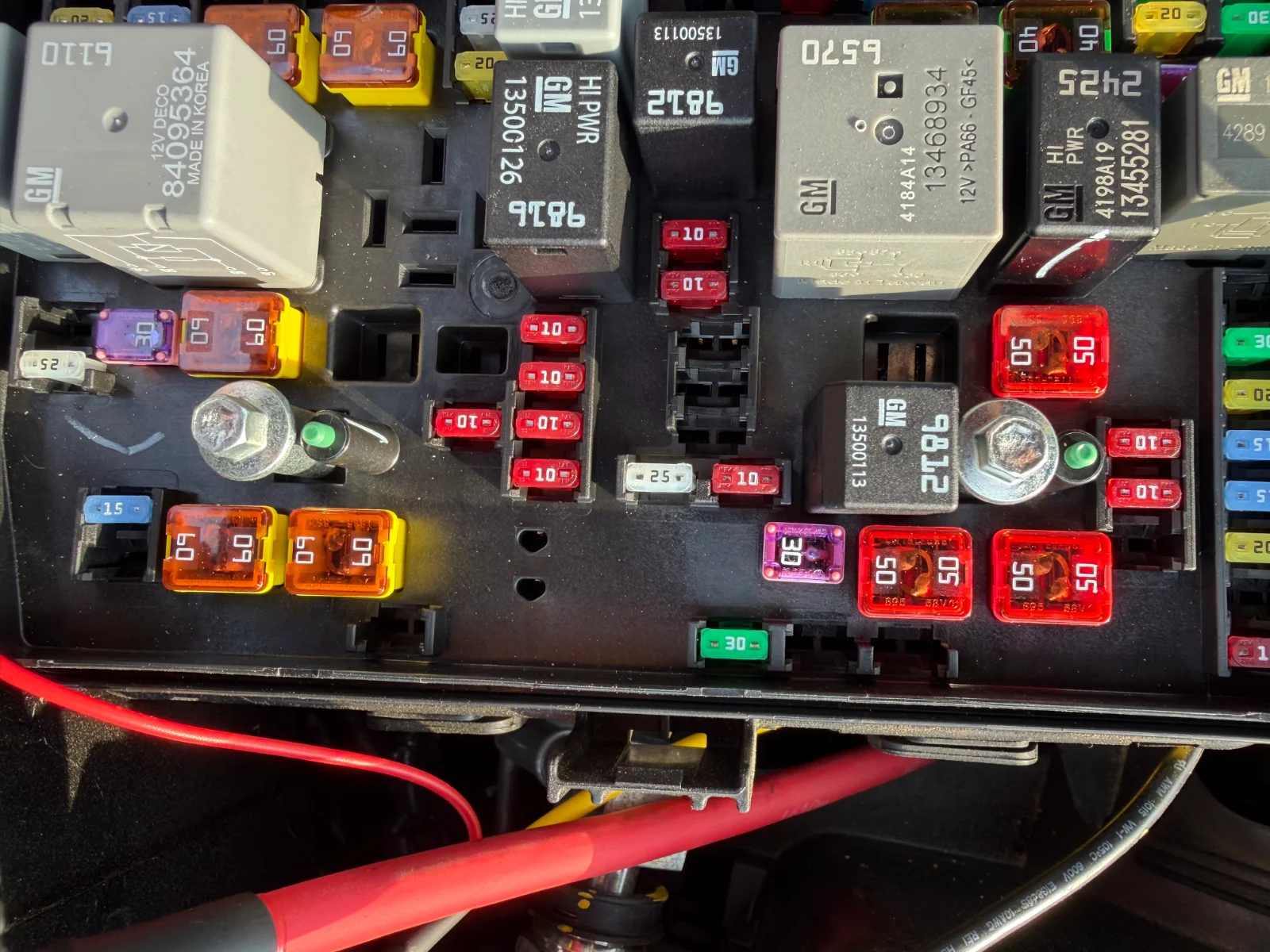

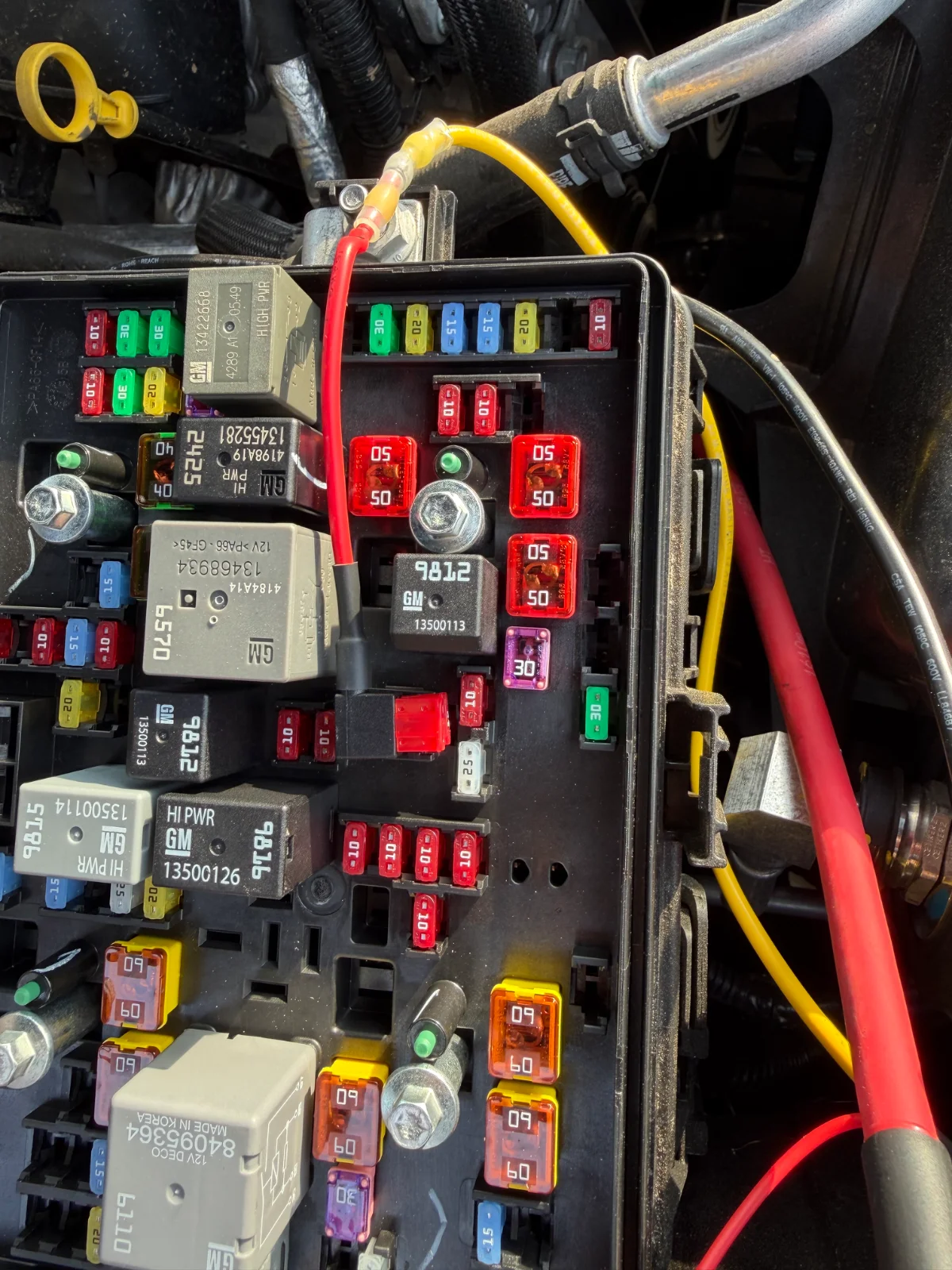

I have fuse 46 as an add-a-fuse for the with ignition

ECM/TCM?
I was thinking about using 38 on mine which is seat fan 10a switched. If I mess something up then my a/c seats won’t work. Lol
Thats a nice mount
I went to a fabricator and payed 200$ for a cheaper version 😶
The NHOverland Garmin mount is a great mount and worth the wait time.
