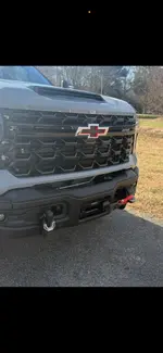

Got my winch installed yesterday. Took a minute to figure out where the manual connection was, and I also realized you have to press the on button (it appears you can leave it on, but it's drawing power even when the truck is turned off).
Both the manual connection and the on button are under the hood on the passenger side. So far so good. Going to replace the red hook with a black one.

I learned that if you leave it on it starts beeping at you after about 15 to 20 minutes and it sucks to have to open the hood every time to turn it on/off.
I'm relocating mine to the inside.
Have you thought about putting the top part of the bumper back on with some modification's? It seems the radiator is some what exposed, after the install, GM stated to leave it off?
You know if you take the hook off, flip that rubber piece 180 degrees and put it back on it'll hold the hook flat to the fairlead for you?
