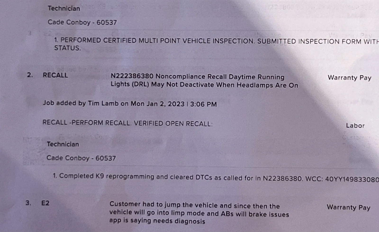

So there’s a recall because the running lights come on on there own and they said that’s what prob killed the battery I suggest everyone go in before it happen to them
Are you sure it's not a TSB versus a recall? Do you have a reference number for this TSB? Should be on the service order. Thanks!
I don’t But when I go pick it up I will post the service document for everyone to see
The other suspicious thing is I just dropped OnStar I’ve never used it in my life and of coarse I get Bombarded with emails for signing back up …… makes me wonder the have the ability to shut your rig down
They told me recall
Interesting...typically, recalls are for safety related issues. A dead battery, caused by a rear seat heater module, are normally TSB's. Please post the recall number and your service order once you have it. Thanks!
Got the same recall on my wife's escalade about the daytime running lights. There's some law where they have decided that having the daytime running lights on at the same time as the high beams violates because it creates too much glare, so they have a software update recall that disables the DRL when the high beams are on to be compliant with this regulation.
