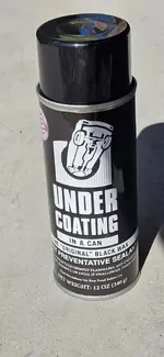

Fluid film is not compatible with the GM wax coating that is on the frame. It has solvents, sonit will eat the wax away.
You're better off keeping it clean and doing an occasional undercarriage wash. Then touch up with a compatible product like this one as the wax gets thin and wears away.
I posted a thread and HuntRedi posted some other stuff he uses.
