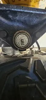

As a follow up to this torsion bar adjustment, I wanted to let everyone know this did not require an alignment adjustment. Had it into the dealer for anothet issue and they checked it and said alignment was in spec. Still rides great after settling in.
Did you get your larger tires yet? Interested to see this fit and look.
