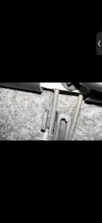

I thought my seat was loose on my 2023 ZR2 as well. When I turned left or right, I could feel a thumping sensation under my seat that transferred into my body making it feel like my seat was loose or a component was loose. I could not replicate it by pulling the seat or shoving the seat back and forth. I moved the seat as far forward and vertical as I could and looked under the seat and there is a component that has a plastic saddle that goes over a metal hanger to “secure” it. There is a lot of play left and right in the saddle and when the truck turns, it slides and thumps the metal hanger and transfers that vibration through the seat and into the body. I had to wedge a small block of wood under the seat padding and the metal hanger. This applied enough downward pressure on the hanger to keep the plastic saddle secure. I drove a few hundred miles after the “fix” with no more loose seat feeling. Not sure if you’re experiencing a sloppy seat or the same issue I was having with a sloppy component connection.

For sure will have it looked into. It’s just hard to get it in the shop when my job hours are the same as the dealership hours and I need the truck to get to work. So someday I’ll have it taken care of properly, but for now, it will do the trick and keep it from being annoying while driving . It’s a design flaw that a simple foam pad on the saddle would have held it in place. It did not happen until recently as the seat became broken in. It’s a sloppy ventilated seat blower motor mounting bracket that’s sliding around.
