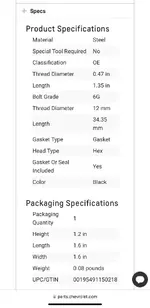

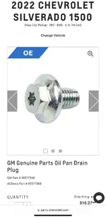

Has anyone confirmed that it's an M12x1.75? There's no official Chevy part to compare and I can't find any site that says they will fit a 2023 6.2. Some say M14x1.5 and I really don't want to trial and error this thing.
When I search chevy parts it shows the drain plug being 12mm so there’s a good chance that dorman part will fit
