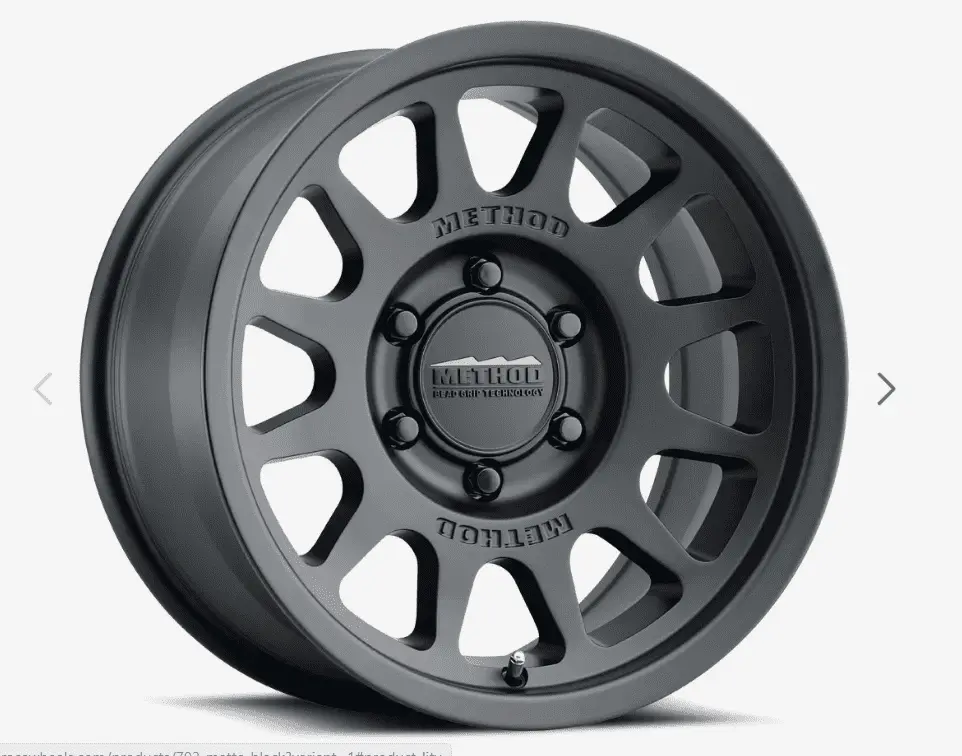

I've been looking at getting the Method 703s in 17x9 -12/4.8
The question is.... will they fit? I'm told they could possibly hit on the brakes or other suspension componentry.
Would love to know if anyone has fitted this specific rim on the ZR2 or has insight on the -12.

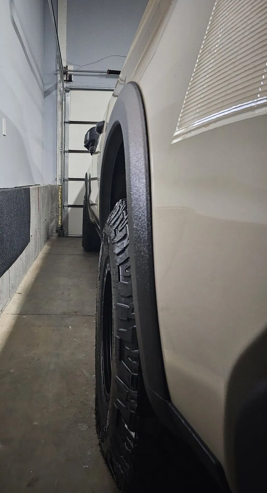

I am currently running the Fuel Off-Road Coverts in 17x9 with -12 offset and don't have any issues with the wheel or brakes. I did have to trim a little of the front driverside inside well. I went a little different on tire choice than most people would have done. I chose the new Goodyear Duratrac R/T in 285/75R17. The ZR2 rides smoother than the stock did. For me, I like the way they sit.
Your setup looks great. Just curious on your front end, is that LineX coated? I see the fender flares look coated too. Did you happen to coat the rear bumper too?
