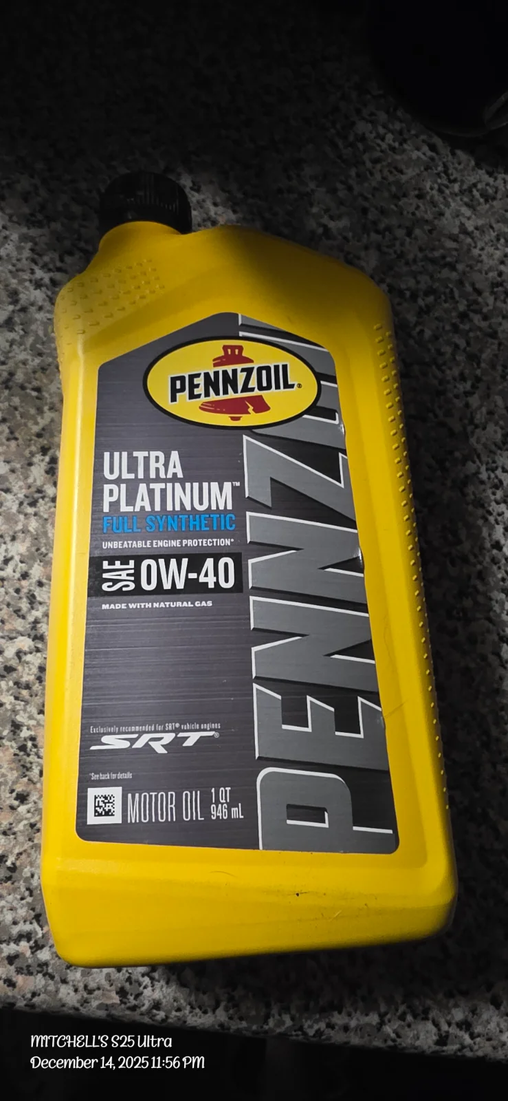

I have been using Pennzoil Platinum synthetic for the past few changes. 6 QTS for $45

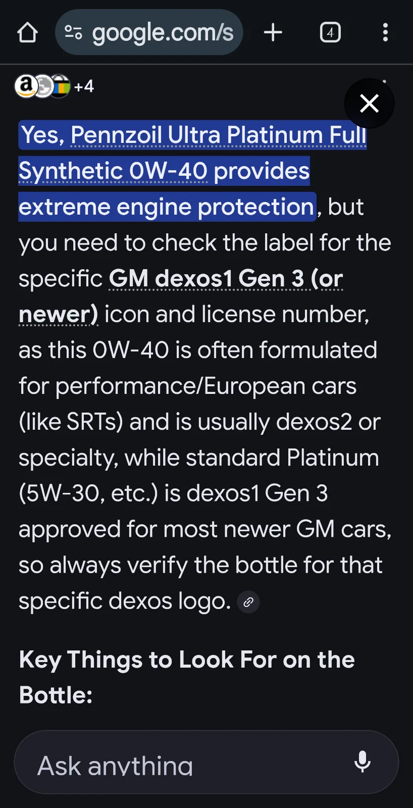

I wouldn't dare run a non Dexos oil in a 6.2. When it blows they might blame the oil. I get it as long as it meets the standard even without the certification it's fine. Just saying, seems like asking for more headaches. I wouldn't give them any possible excuse. If I still had my 1500, I'd be dotting my eyes and crossing my Ts on all maintenance. When the rollback drops it off at the dealership that sucker would 100% have ACdelco filters and Dexos fluids and service records in the glove box 😅
I understand Dexos is a quality standard but as far as GM's published list of Dexos R "certified" oils go, Pennzoil is not on the list. I answered the question KLA asked.
Can you please share the GM Published list of approved oils?
