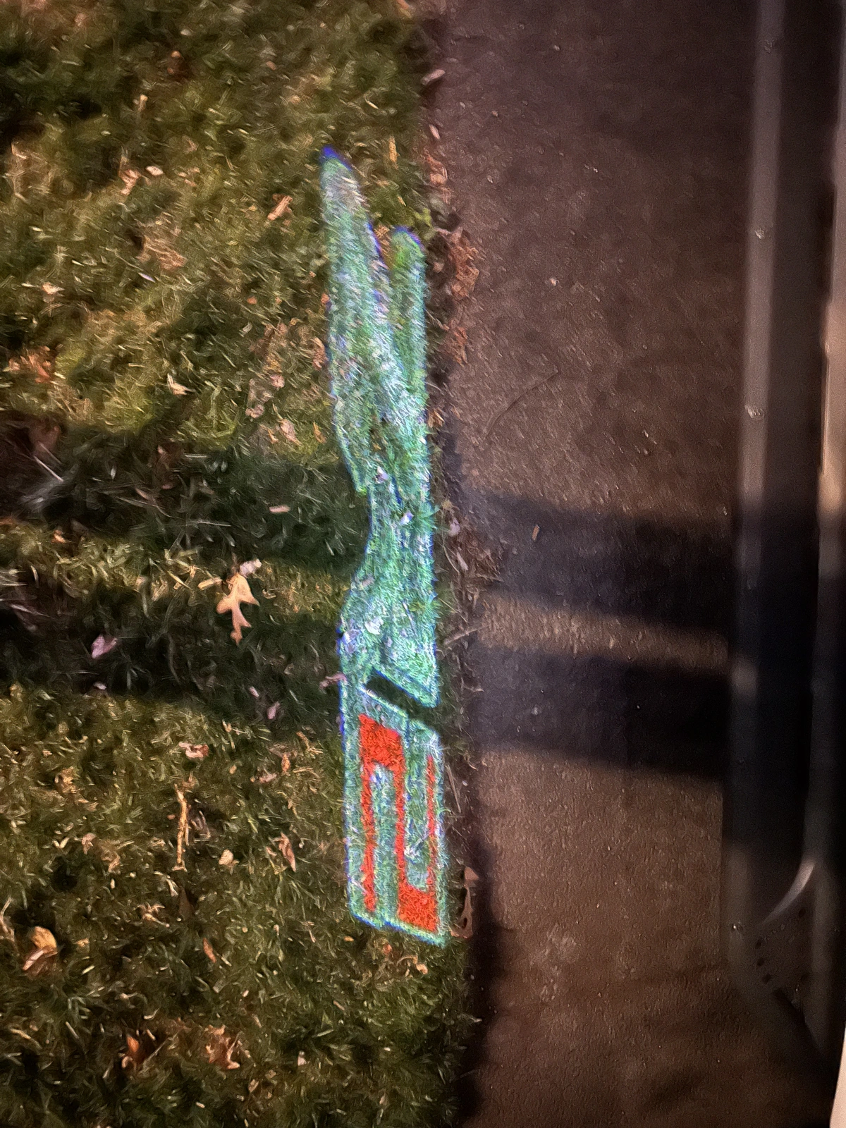

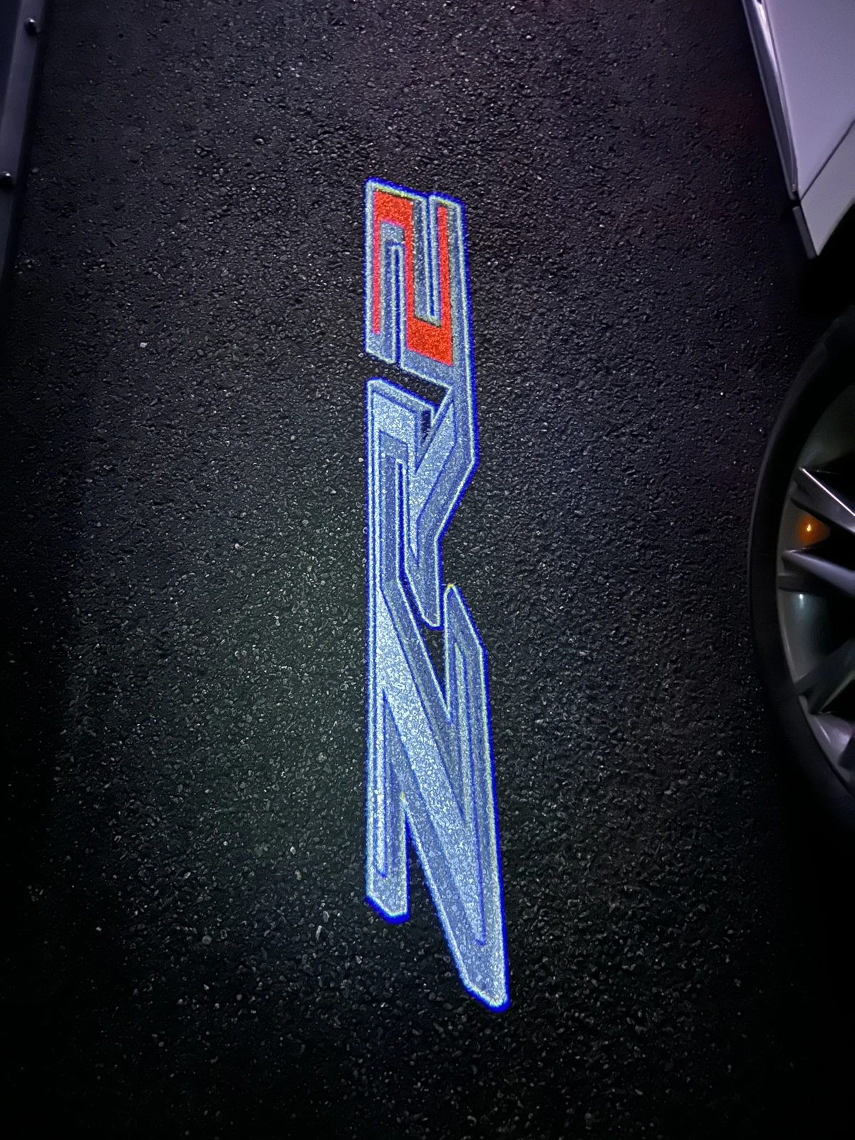

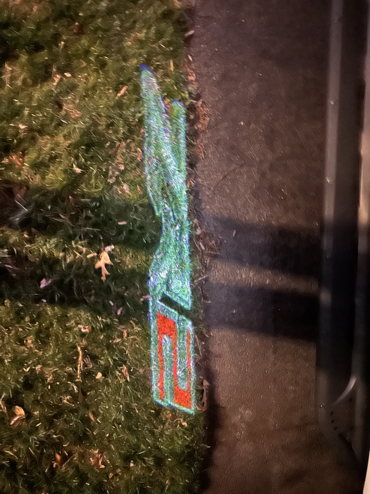

Ok, moment of truth and opinion. The lights were easy to adjust to whichever direction I wanted, ZR2 readable as you exit or as you approach the vehicle, NICE! Are they brighter than the stock units, yes, are they as bright as they look in pictures, no, these new cameras on our phones can take pictures in pitch black and make it look like it’s dusk out, so this picture looks brighter than they are in person. The first pic is on the asphalt driveway and it is fairly dark out with not much light around, the second pic is from the edge of the driveway in the grass with a light behind me which is a pretty bad picture but is representative. I like ‘em a lot!!!
Thanks @Mixander Xi !!!

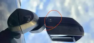

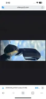

This might have been asked already. Will this also work for the 2500HD model? 2025 Bison
Could you take two similar photos? I'll help verify if your vehicle model is compatible with puddle lights.
As long as you have the puddle lights, they should work. Normally, they can be directly replaced and used.

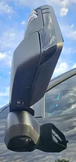

They did not fit my 2500 ZR2. I sent an email for a return. Darn wish they could have worked. Here are mirror photos
That’s wild, I know someone with the exact same mirrors, fit fine. They don’t just fall into place but a little upward force on the tang with the mini screw driver tip and they clicked right into place. Were they too big for the hole or?
How did they not fit? Were they loose? They are loose enough in mine that the image will no longer be parallel with the truck.
That is also weird, they fit extremely well and tight in place on my truck, and a simple rotation of the clear lens has them lined up perfectly to the line of my truck and they haven't moved since, are you positive they are fully seated and latched into place?
From your profile photo of the white truck you have completely different mirrors. The 2500 hd mirrors look and are different underneath. I will try again. I bought the factory bow tie puddle lights months ago and they went right in no issues. I like these much better and will try again.
Yes, they are fully seated in place as you can’t really put them in any other way. Not sure what to say as for why they aren’t snug, they just aren’t.
You say they are flush, but you don’t say that the clip is seated into place, both of mine needed to have the end of the clip tang pushed up a little hard to flex the elbow enough to get them to fully seat and click into place, the drivers side went easy, the passenger side took a bit of pressure, I used the tip of the little screwdriver to push up on that tang tip, these lights the tang is just a little lower than the factory ones, but once in place are solid.
