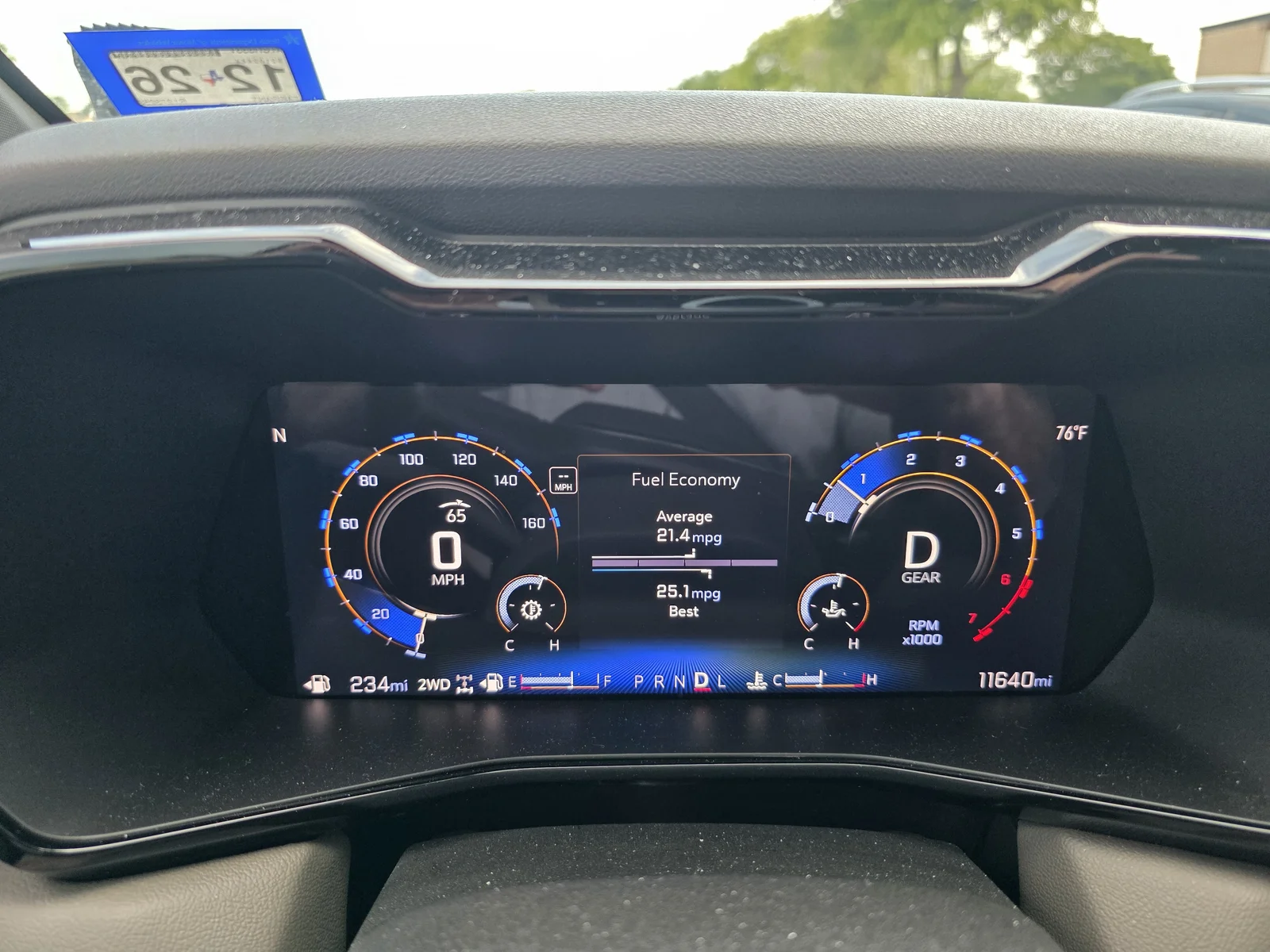

Just got back from a trip to Fort Worth some highway mostly slower about 50 miles round trip. This was taken when I got to my destination in Fort Worth. Made it to 22.9 before I got home. The 90-octane ethanol free fuel is awesome!!
