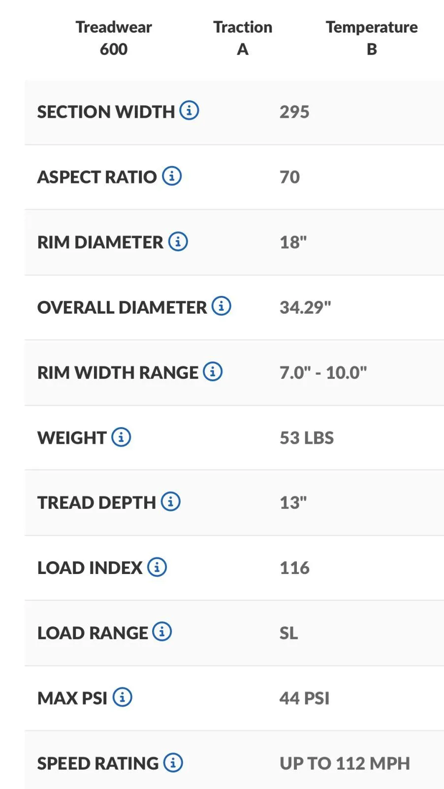

If any 295’s will fit without rubbing the recons would be the ones. The tread depth being lower means the tire itself is on the smaller side. They claim it’s the same OD as the LT version which isn’t possible given the lower tread. It’s not much but it’s measurable.
17/32 on the LT and 13/32 on the P metric. A difference of 8/32 or 1/4” in OD.
With those numbers it’s a 34.04” tire.
A 285/70 would be 33.99”
Which seems to be the redline for the T1 Silverados with the Trailboss ride height.

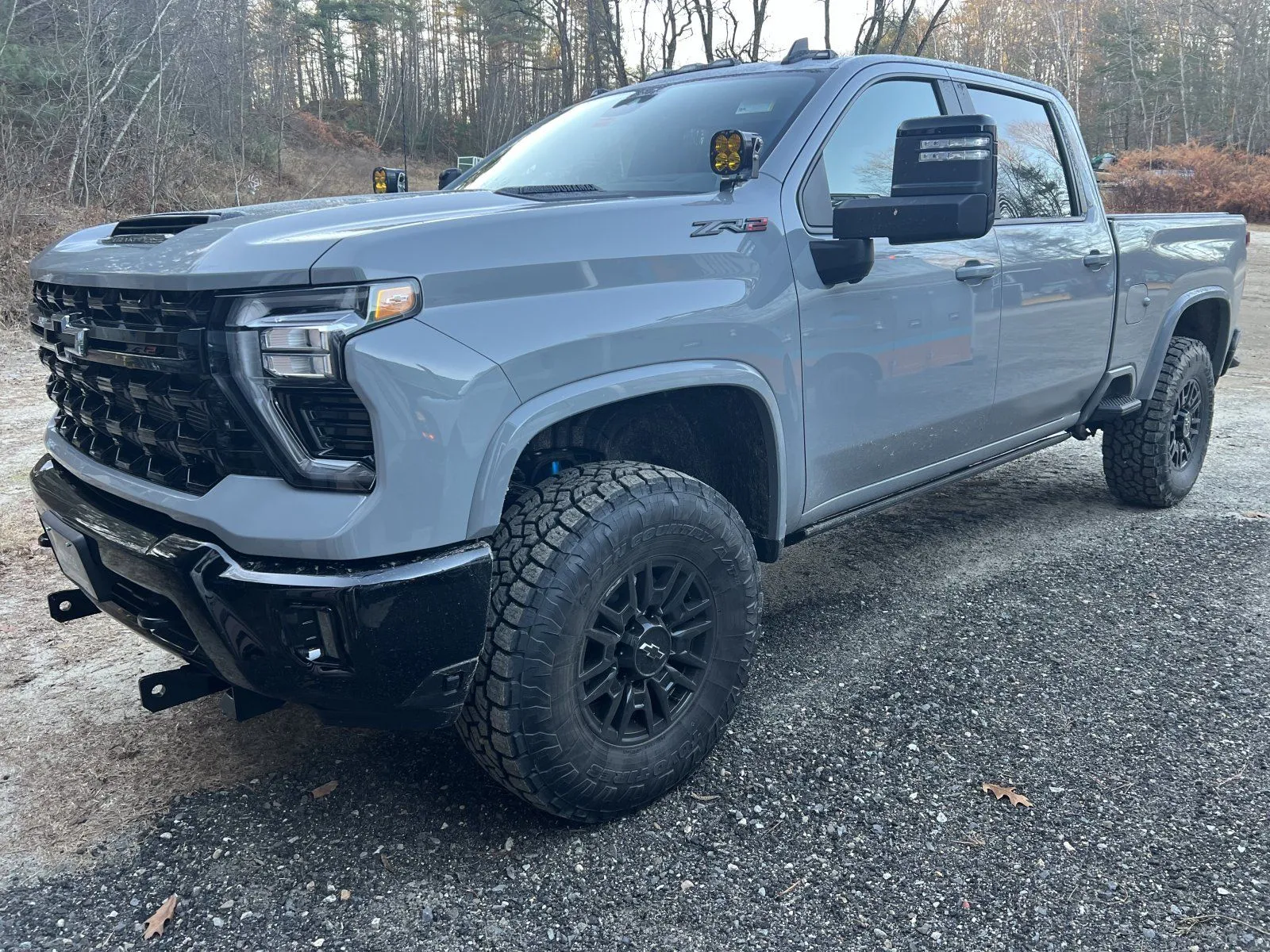

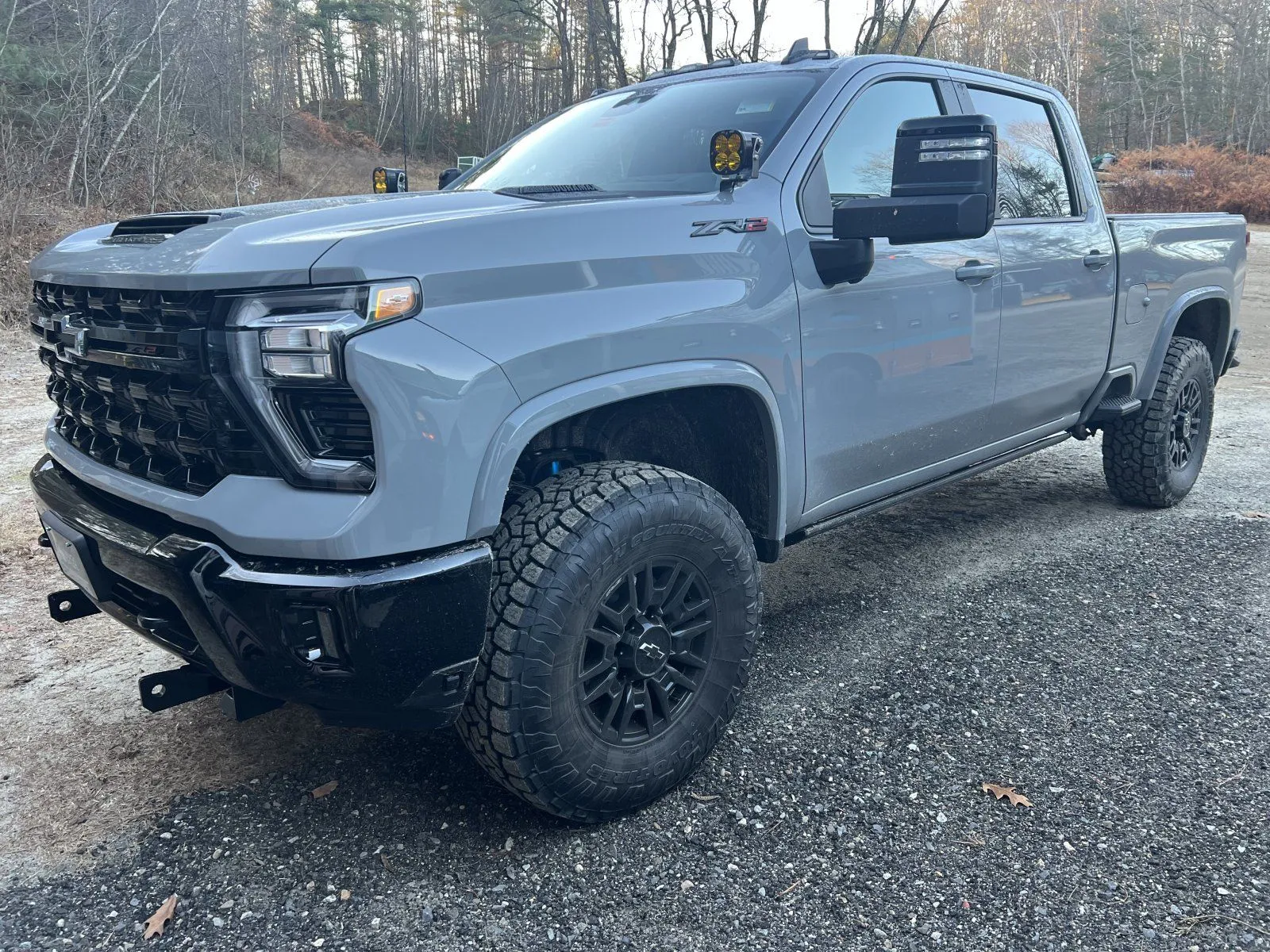

I ran the exact set of recon graps you are talking about on a 23 AT4X 1500 no fitment issues or rubbing. I had them on the stock wheels. Good combination of larger tire and weight. They are noticeably less aggressive than the E counterpart. Smaller tread blocks and smaller sidewall. I now have a 24 ZR2 2500 that I am running 37/12.50 toyo at3 on stock wheels. Again no fitment issues or rubbing.
Well if they fit the GMC, the definitely fit the Silverado. Sierra’s wheel openings are even smaller than ours.
Post some pictures if this 37s.

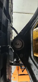

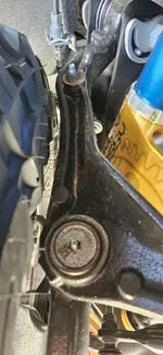

I put a Toyo MT 37x13.50R18 on my 2500HD stock AEV wheels and while I had enough clearance, it was too close on the UCAs for my liking when offroading or airing down. Gonna do some - offset wheels.
