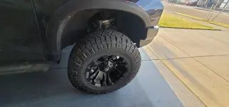

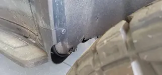

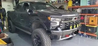

Right now, I'm trying to finish up the trimming and fender flares as the ZR2 has that weird 2 piece trim piece on the bottom. The guy Chris, who posted how he cut out the crash bars and trimmed his to fit 37's, (thanks for posting that Chris), gave me a sneak peek, and overall it is an easy mod. The only thing I ran into was I had to remove the corner section of the plastic on that lower piece, (He kept his) so I could get proper clearance. My first cut, (similar to his) left only about 3/4" and I know I'd rub at an angled descent through any kind of rock garden, so, off it came, thus the open part of the plastic in the photo. New flares will fill that in and make it look finished and proper, so for now, I'm just rollin' hillbilly style on that.

4 inch BDS lift, kept the DSSV's and OEM driveline angles - drives like factory, maybe better as I have more rubber on the ground
37x12.5x20 Nitto Ridge Grapplers
Fuel Vapor 20x10 18mm offset wheels

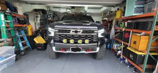

(4) KC Flex Era 4's up front - these things are SOOOO bright, and have a super cool "Glow" setting, i also have (2) amber lenses for fogs as needed.

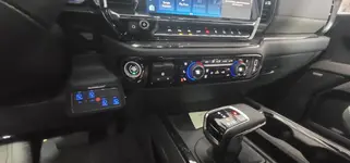

Auxbeam 8 zone controller.

When I got my ZR2 I really liked the way it sat and thought, I’m not going to lift it, but this set up makes me wanna go to a 4” lift. It looks great!

What fender flares do you have and where did you get them?
Those are bushwacker OE flares that were cut to fit and plastiwelded back together and color match painted. The custom shop did them when they did the rest of the truck.
That's what I thought. Figured they were custom made, but was hoping that someone finally made a set of fender flares for the Silverado ZR2. No luck, I guess. Custom is the only option at this moment. Thank you!
