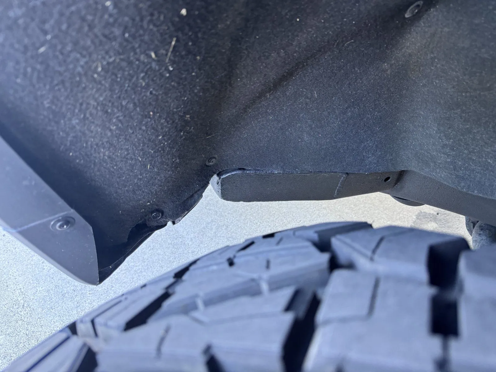

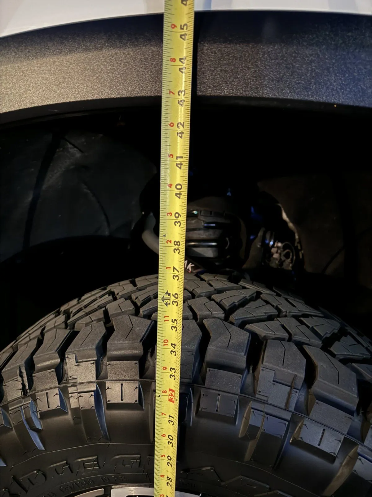

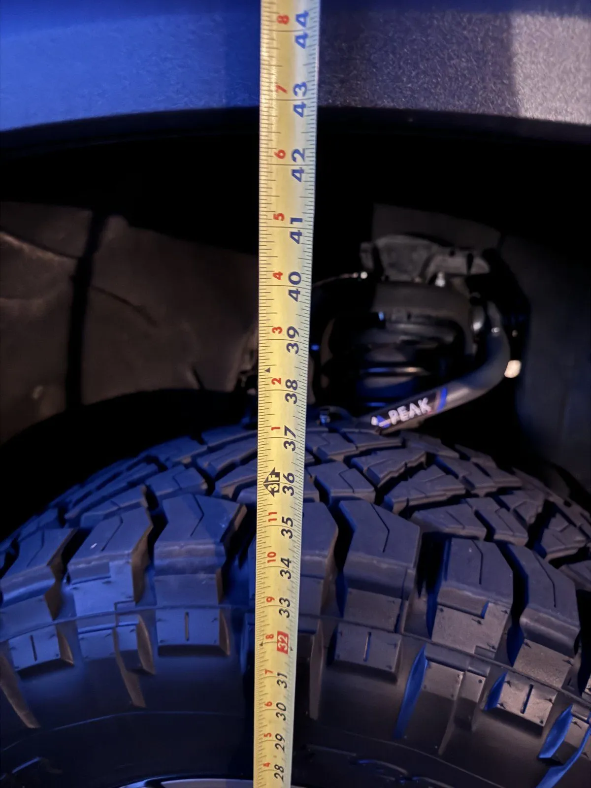

I have the Peak 2.25” kit which includes the preload spacer and top strut spacer. I am running the Peak UCA’s as well and I measure 43” after alignment in the front.
With the Peak kit, some trimming, and spacing out the front bumper about 5/8” I am able to run 285/75 R18 (35x11.25) Nitto Ridge Grapplers on the oem wheels with 2” wheel spacers without rubbing.

So you’re effectively sitting at a roughly -24 offset?

Yeah, right around -25. I think the stance looks so much better.

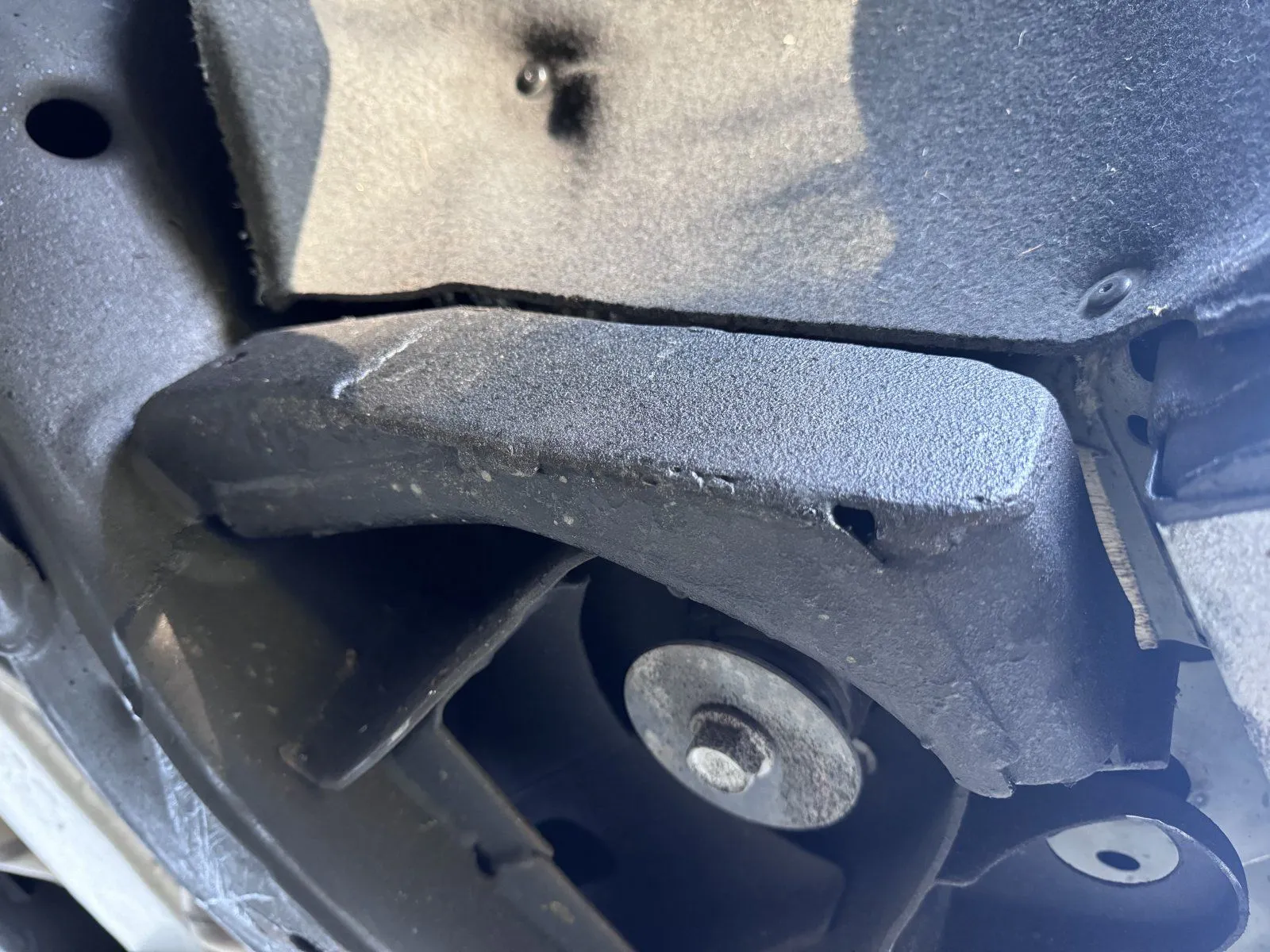

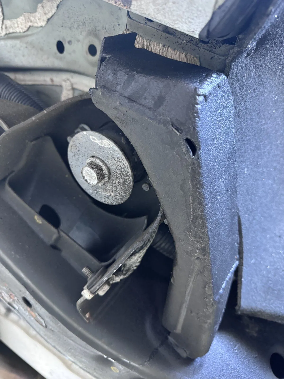

Some people cut out the crash bars behind the front wheels all together. I chose to cut out the large curve and welded in a flat plate so I still retained the bars.

Here are some pics of the mods with welded plates to the crash bars.

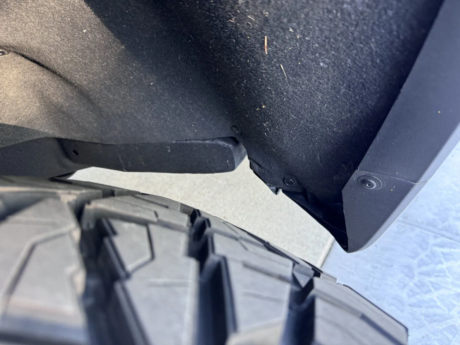

would you need to trim if you did not have the wheel spacers ?
I never tried it without spacers with the larger tires. I ran the spacers on the stock tires and only had some very minor trimming to the plastic at the bottom rear of the front wheel well.
