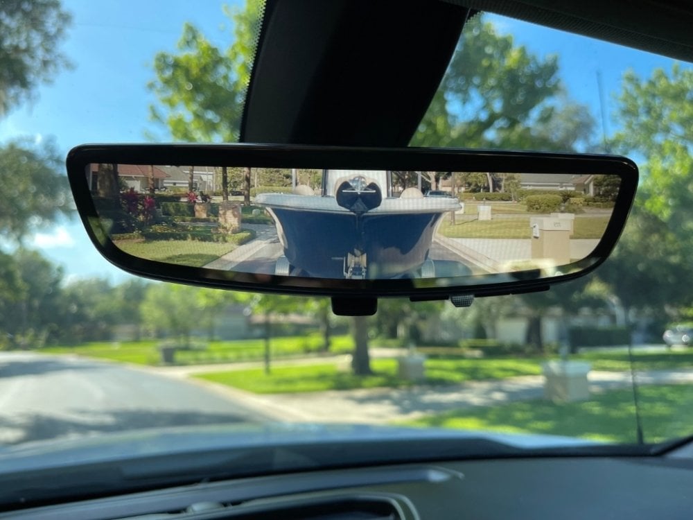

Just wondering if anyone can tell me what this plug is for ..goes into the mirror assembly,.. wanting to fit a wolfbox g900 mirror cam to use as my dedicated rear of trailer veiw
Cheers

I’m probably wrong but my first thought would be that is the feed for the rear view camera.

I thought maybe it's to do with the auto dimming of the mirror,
I guess I'll disconnect it &see ?

The mirror is Electrochromic. (self dimming)
The rear vision camera if equipped uses coaxial.
You can tap the leads for power without issue. Mine is tapped for my V1.

Was more concerned with disconnecting the plug as I'm changing the complete mirror . Mine has no rear vision camera equipped. 👍🏻

hey are you changing the mirror and the 3rd brake light (with the camera) to get the rear view camera mirror ? cuz i was wondering if just changing the mirror will work on its own ?
For it to work in the ZR2 you need the LCD rear mirror and the third brake light with 2 cameras (one for bed and the other for the rear mirror) and connect the rear mirror with the camera with a fakra cable. And to do that you will have to lower the head liner.
