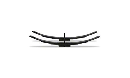

I would call a lift shop like NorCal Truck and ask them about a heavier duty spring pack. If they are designed right, you'll get more leafs in the pack and it will support loading better, but not create a notably harsher unladen ride.
Deavers must make one for the 1500s that would work with ZR2.
