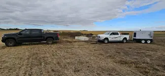

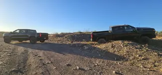

I pulled two 2500s out. One had a 125kw generator hooked up. So that has to be over 10k lbs. Not sure what your gonna pull out, but if it's heavier than that, you might trade it off for a 2500HD ZR2 with the Bison package. It has bumper hooks integrated into the frame.

Wow, that’s pretty solid. This was with the 41twentytwo piece? That’s impressive performance.
Yeah, made in USA and I see 10% off now. When I got it, I thought is was a little too lightweight. They claim 37K break strength. Figured what the hell I'll give it a whirl. Seemed pretty strong.
Those were both dead pulls as vehicles had no traction, so I was pulling the full weight. I was using a Bubba strap.
I have a flexible Bubba recovery rope that would also allow for a heavier pull. I use their soft shackles too. Easy to hook up.
