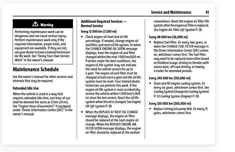

Guys I don't understand why you are all doing all this maintenance when the owners manual doesn't ask for it:

One of the reasons I do it is because I routinely keep a vehicle for 15-20 years, GM only cares that it makes it through the warranty period, and they are willing to roll the dice on that too, their biggest concern is making cost of ownership look as low as possible and to hell with longevity. My oil gets changed 3 times in the time they call for 2, and that alone can make a huge difference in not only wear, but in spotting a problem before it becomes catastrophic. Fluids are cheap, engines/transmissions/differentials etc. are expensive.

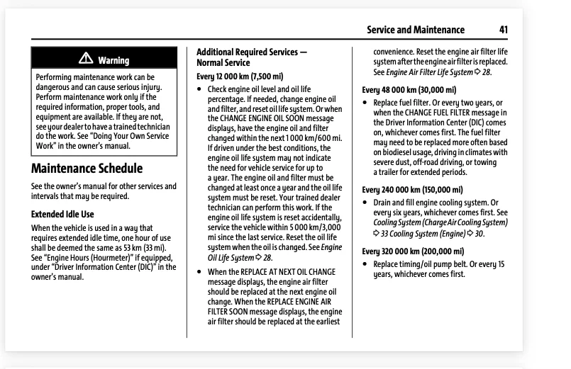

That's the bare minimum they can do to keep you under warranty without having to do much work on the truck.... Then after the warranty expires your screwed and by then it too late to take care of your engine properly....main part of damage is done to an engine in the 1st 60k miles. CUT EVERYTHING THEY SUGGESTED IN 1/2 or 1/4
