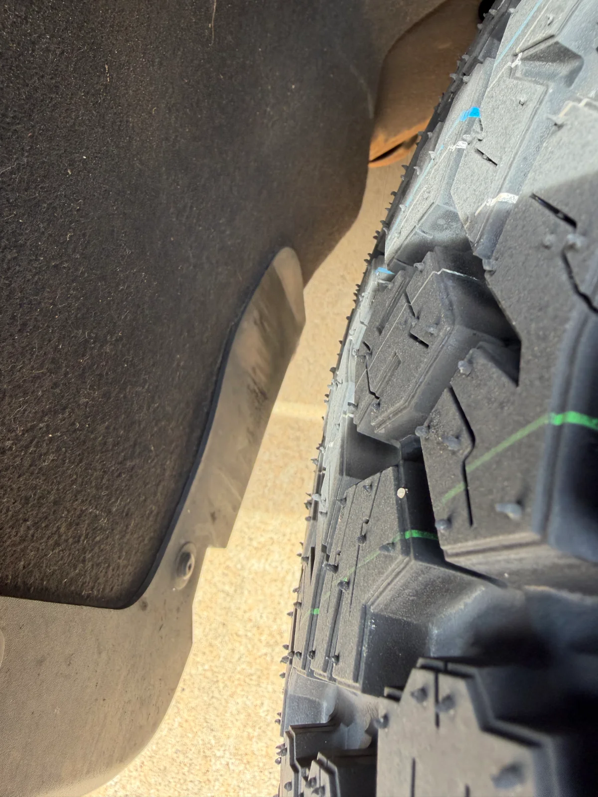

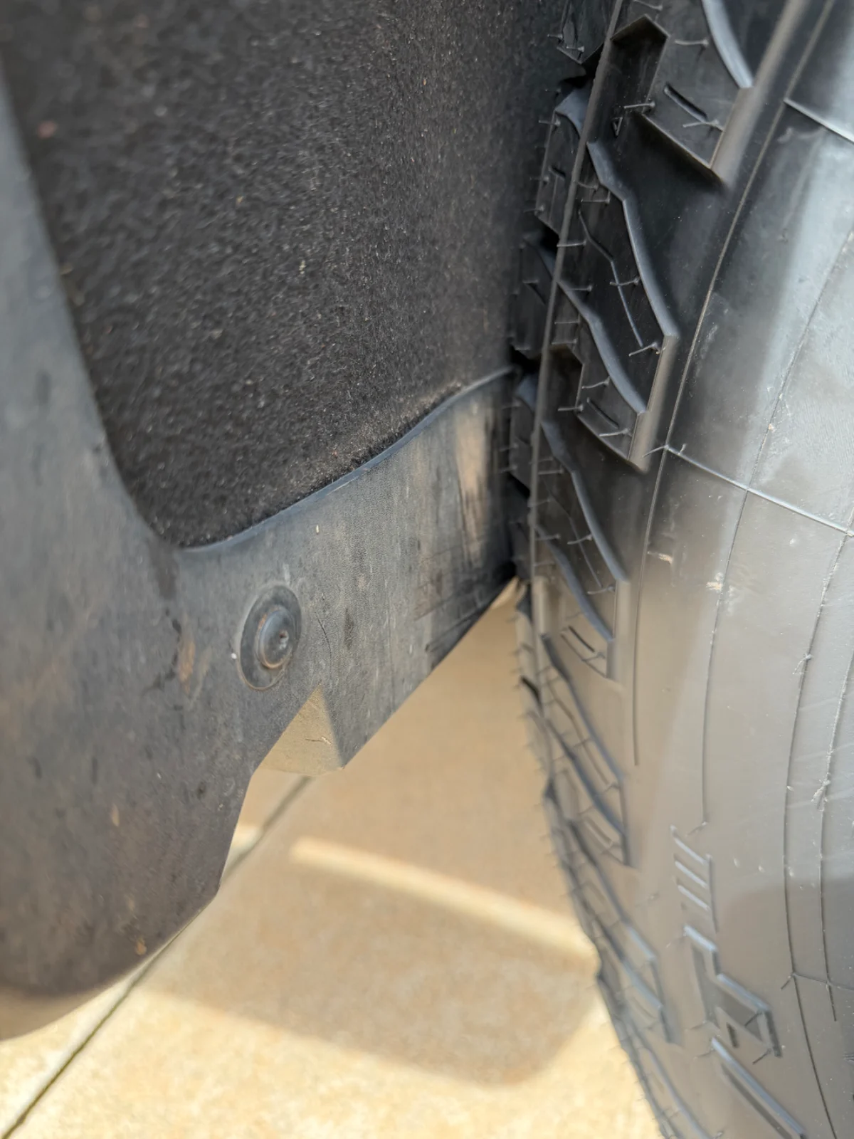

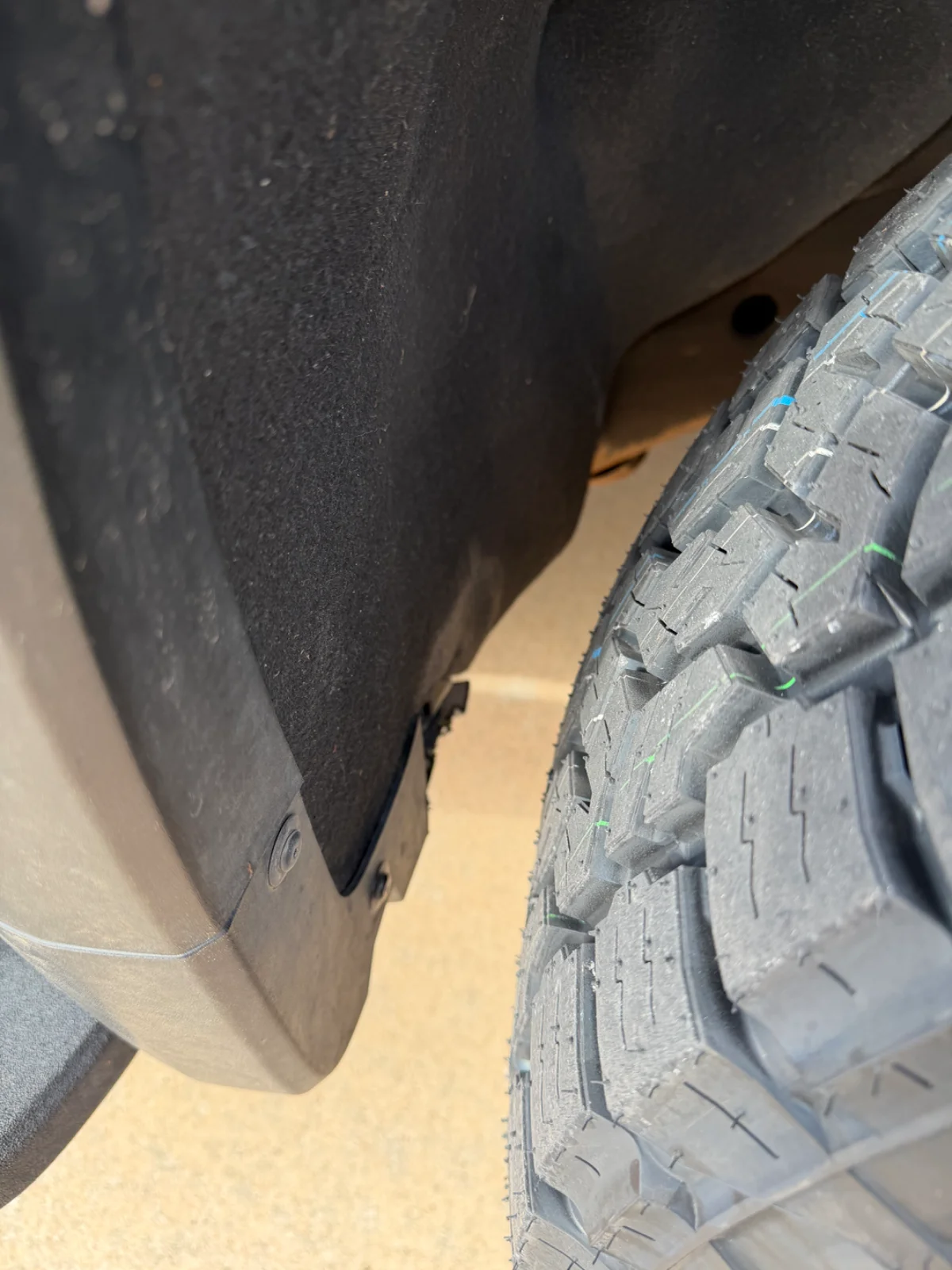

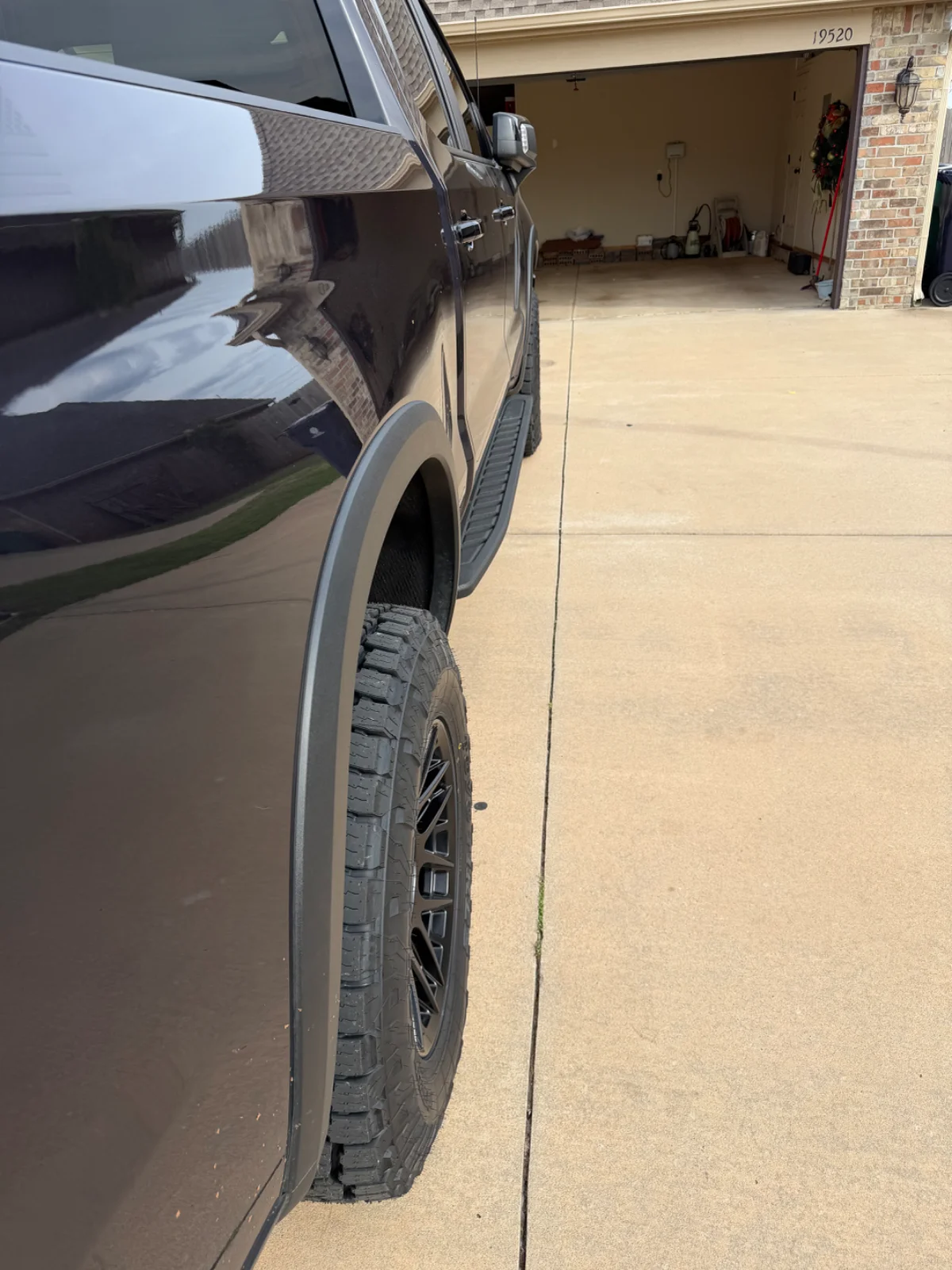

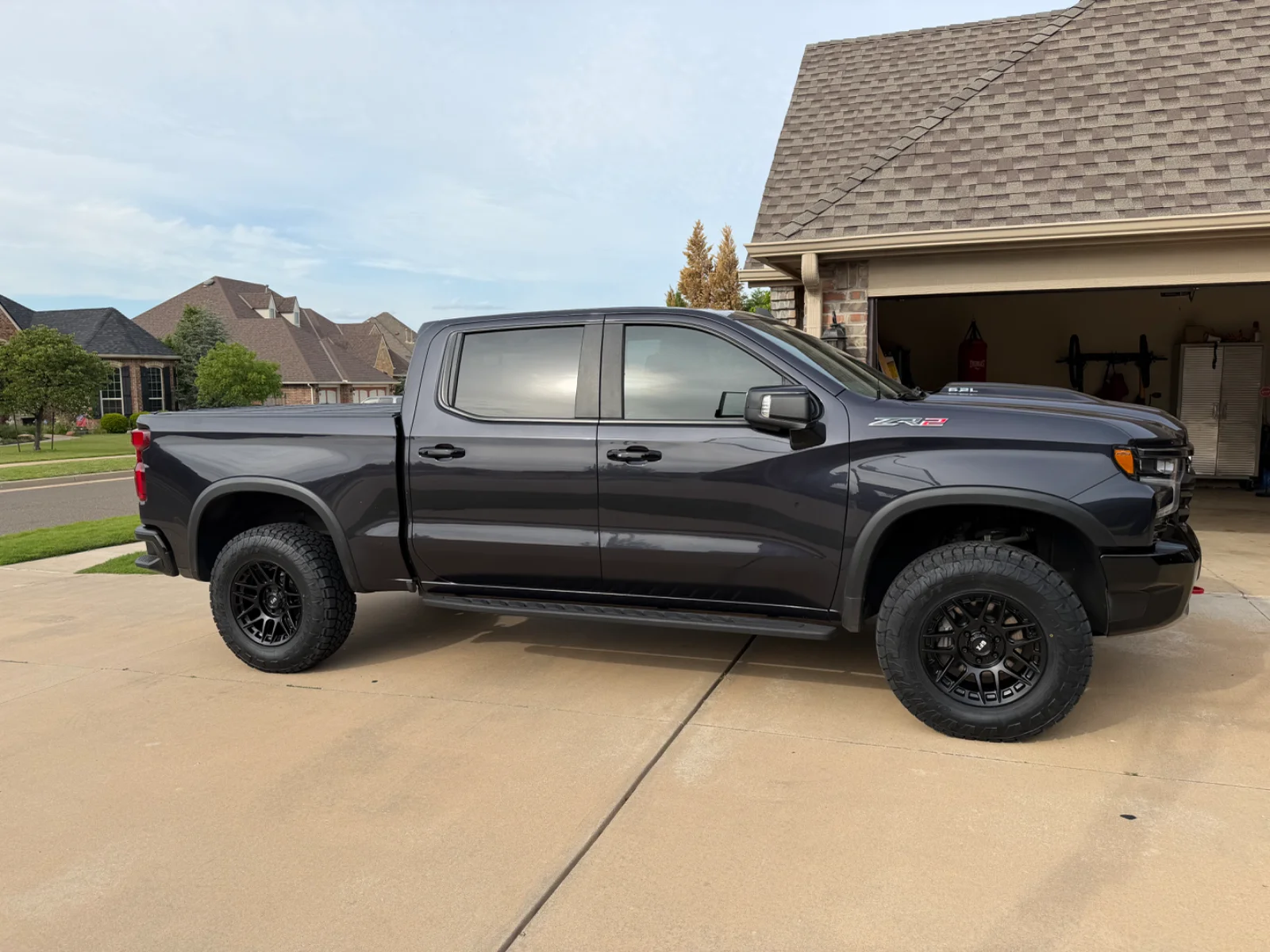

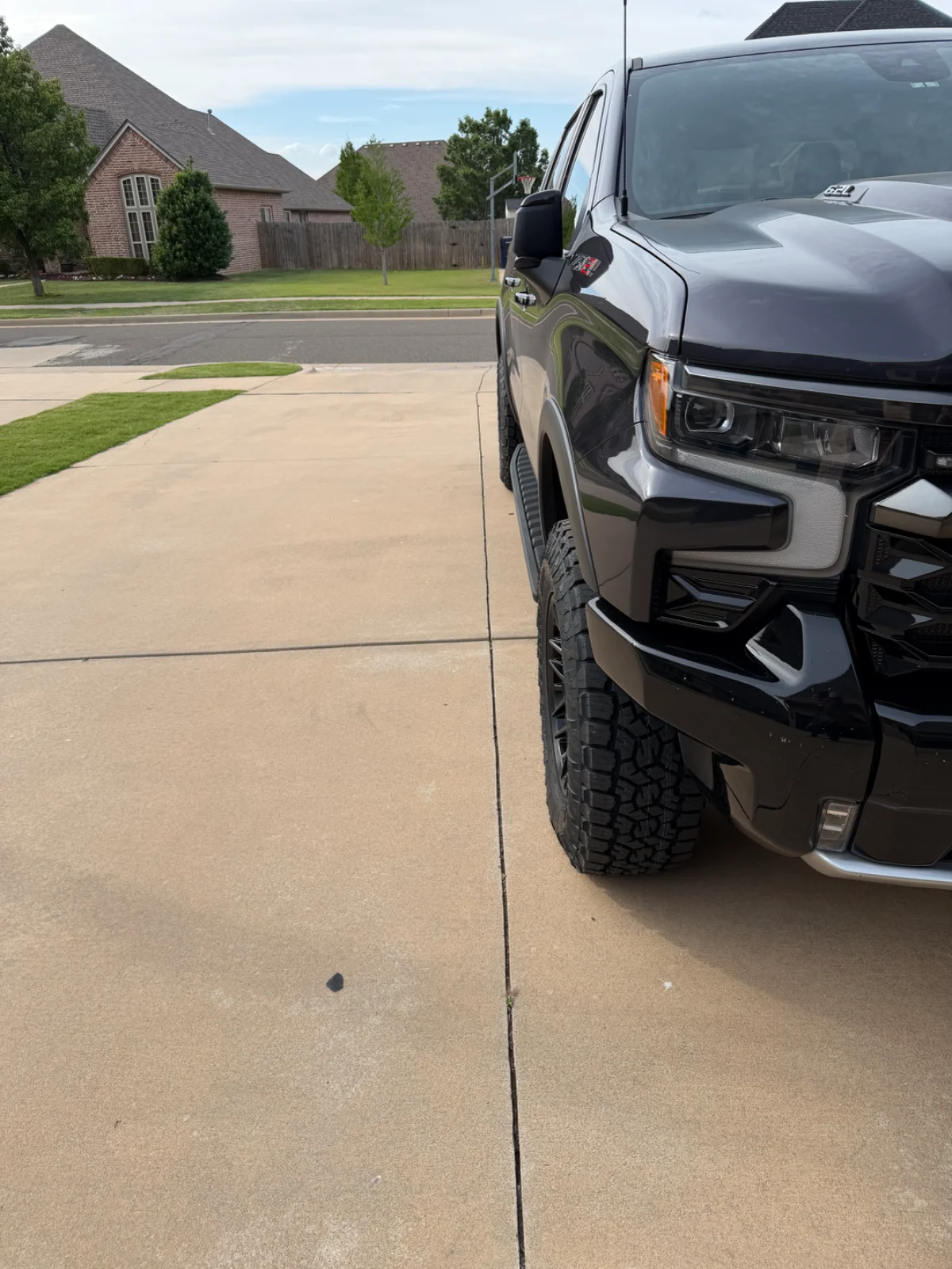

got the new wheels and tires today! The 285/70/18. Wheels are at zero offset. Had to do minor trimming on the front passenger back side of the wheel well. Other than that everything is running well!
