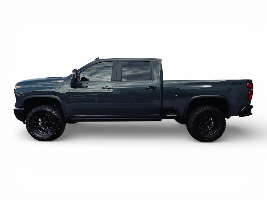

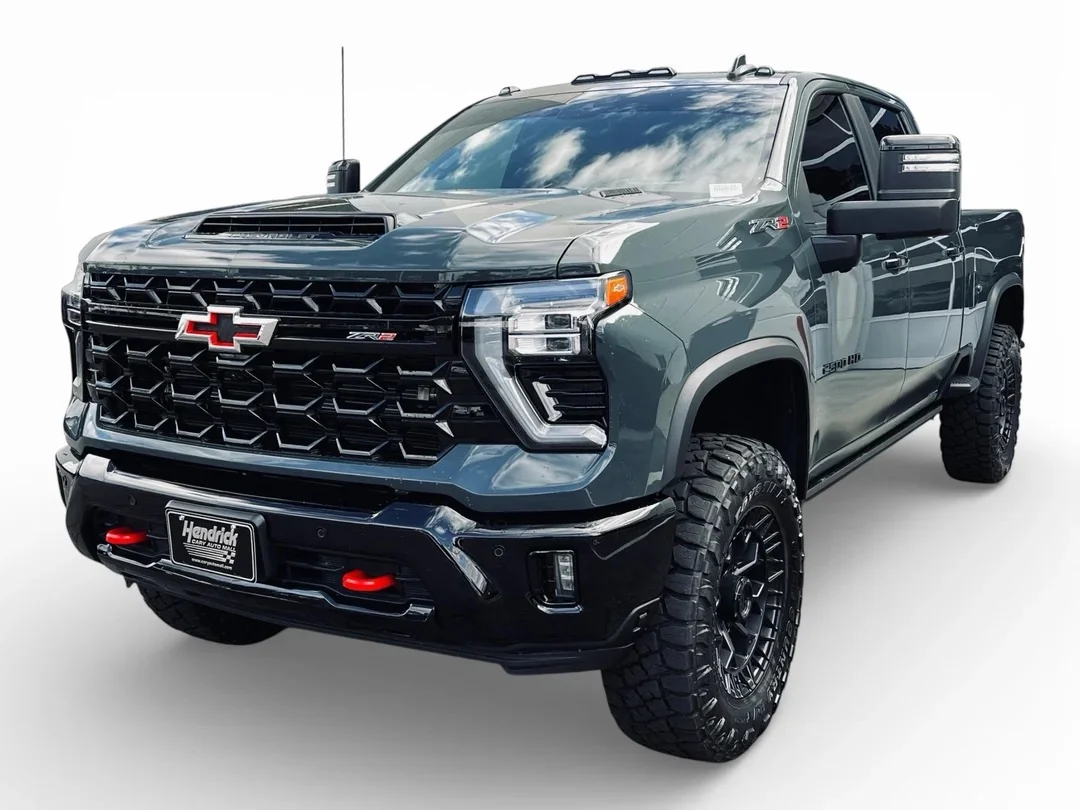

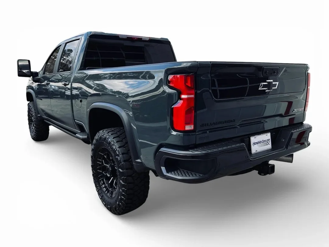

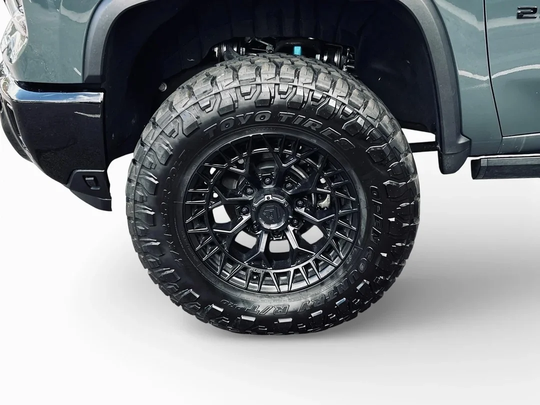

This ZR2 is on 37s. Does it look like a +1 or a -18? Stock ride height?
Apr 10, 2025
15
27
My hunch is +1, but I cannot find my pics online of these rims on trucks. I feel like a -18 would poke out a lot more. I am leaning towards this look (these same rims on 37s). AEV sells a kit to fit 37s. Does this look stock ride height?
Looks like a 0 offset 20 inch wheels and stock height truck Keep in mind the ZR2 sits big. It's 83 inches to the top of the cab at the B pillar with 35s. That's basically the same as a 6 inch lift on a 2500HD of yesteryear.

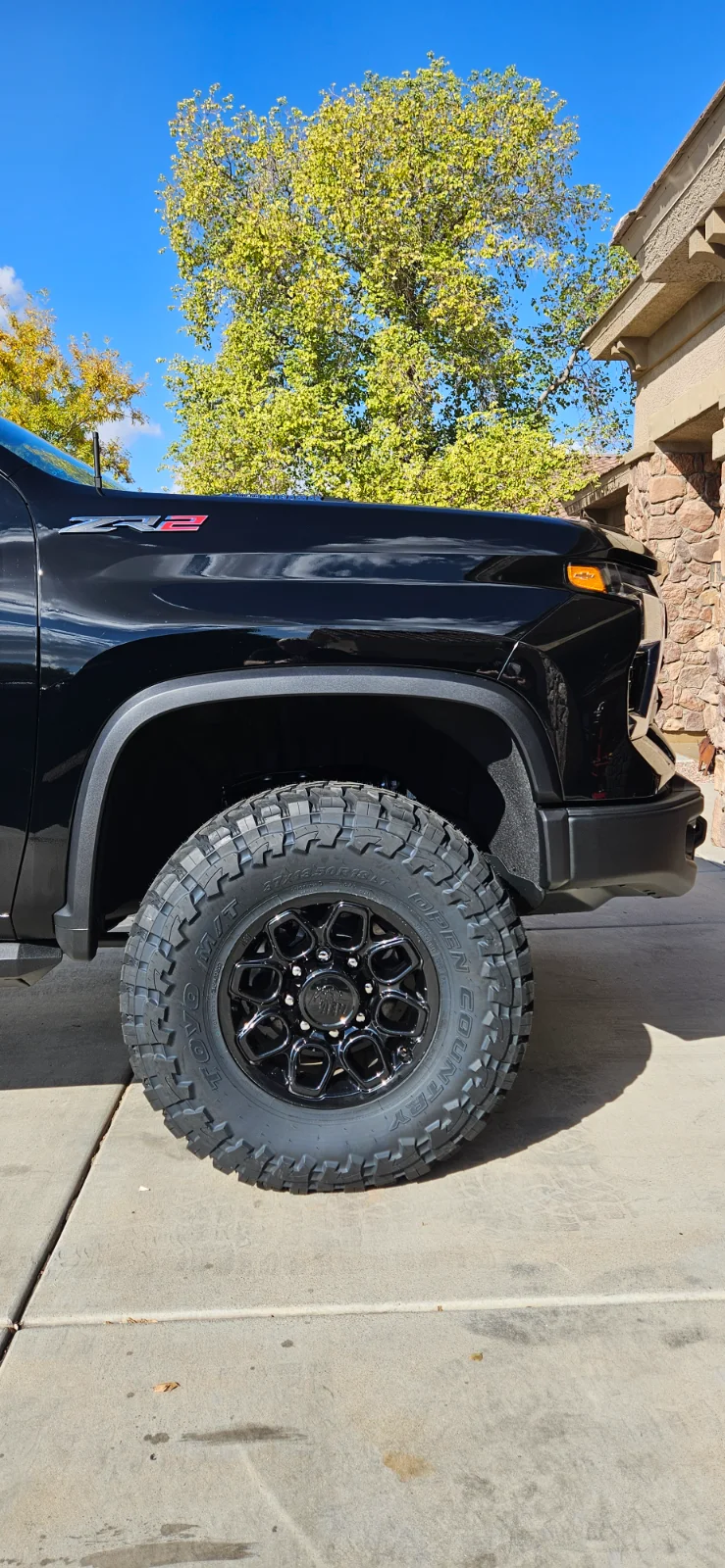

Here's one on front, but doesn't show turning positions wick would get closer.

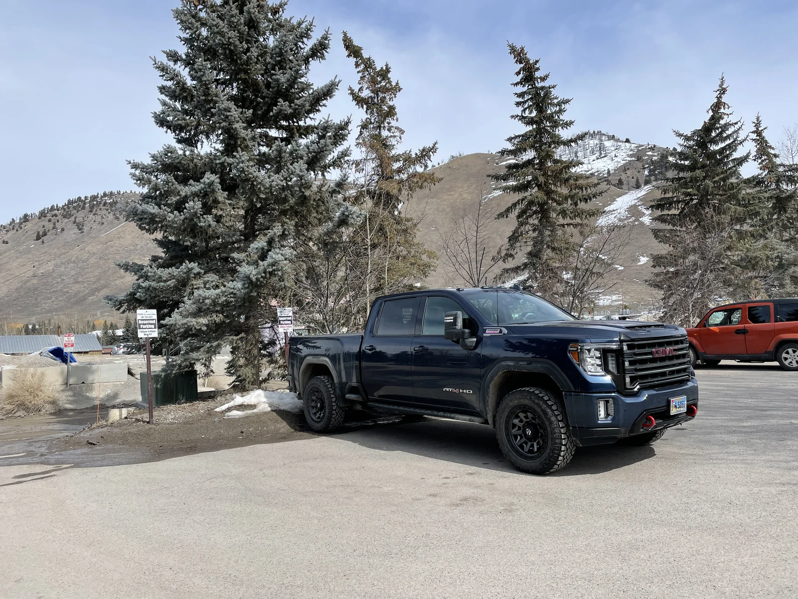

I think those wheels are -18. I had a HD AT4 before my ZR2 and ran +1 Fuels and they were not out that far. I’ll look for photo to post.
