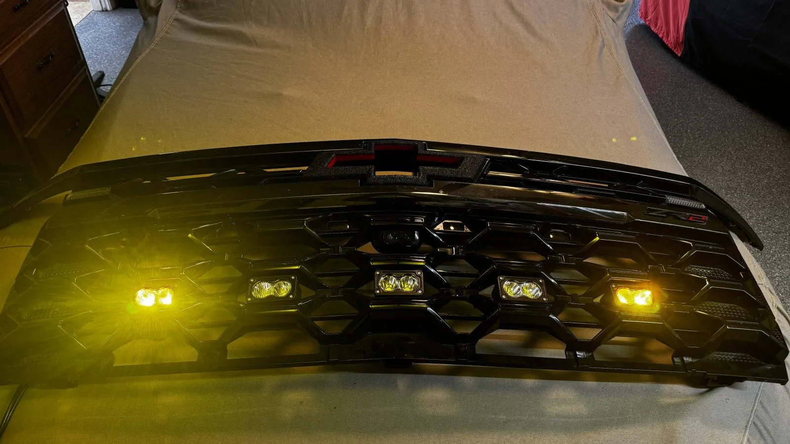

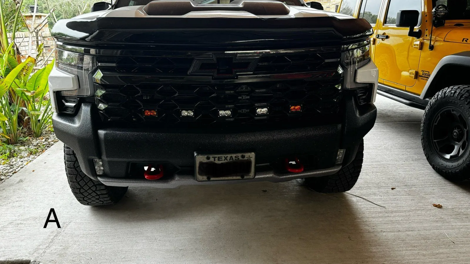

Finally pulled the grille to install my lights. Spent the better part of the day mounting and running wires.

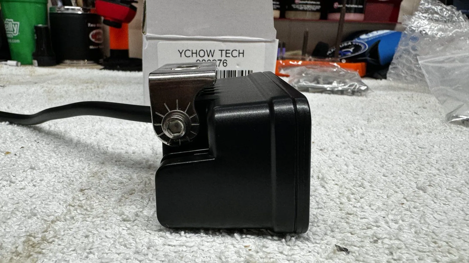

The lights don’t require anything special to mount them into the grille. They friction fit nice a tight. I used the light’s supplied bracket to keep them in place.

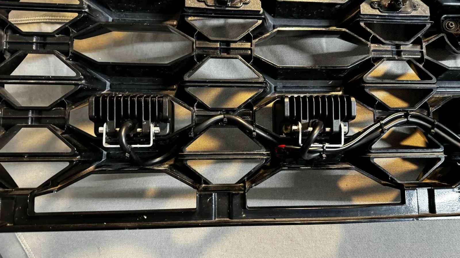

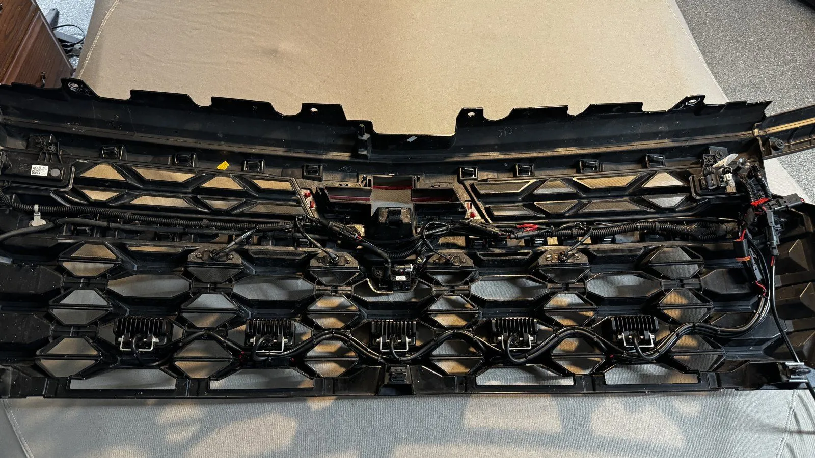

I drilled 3/32” holes in the grille supports to use zip ties to hold the wires out of sight.

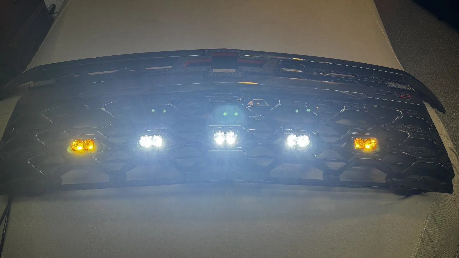

Did a quick couple of bench tests to make sure my wiring was good. Then did another couple tests once I put the grille back in place.
I’m pleased with the results. Tomorrow my AuxBeam controller and DeeZee ditch light brackets arrive. So more fun to be had.
