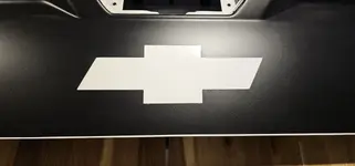

@AXE Was right. There is a bowtie cut out on the flex bison wrap. I just wanted to check.

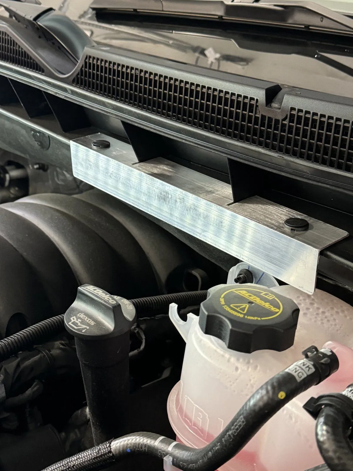

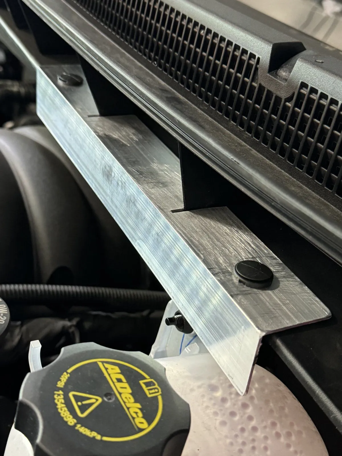

Fab’d up and installed an aluminum bracket for future oil catch can install. Haven’t decided which catch can yet but it will get mounted here. Just trying it out until then. Will paint it and mount with proper fasteners when I install the catch can.

Why? The J&L can is an OEM design and easily mounts to existing hardware. The J&L is top notch and super high quality.

All the catch cans mount with that one stud for the coolant reservoir. Every video I’ve seen of emptying the can causes the mount to move/pivot around the stud. I’ll drill an extra hole in the can bracket and have two points of contact to attach it my bracket. Won’t move when emptying the can.
Hard to explain but it’ll be clear once I put the can in soon.

I understand what you're saying. I have emptied my J&L numerous times and the can moving was never an issue or a concern.

Your truck, do what you like to it.
Custom aluminum mount is a nice touch.
