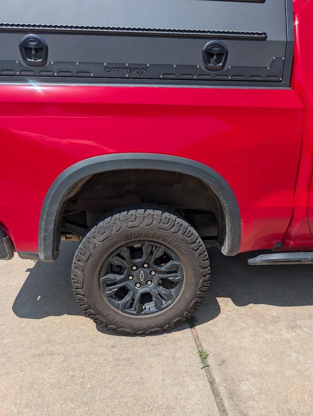

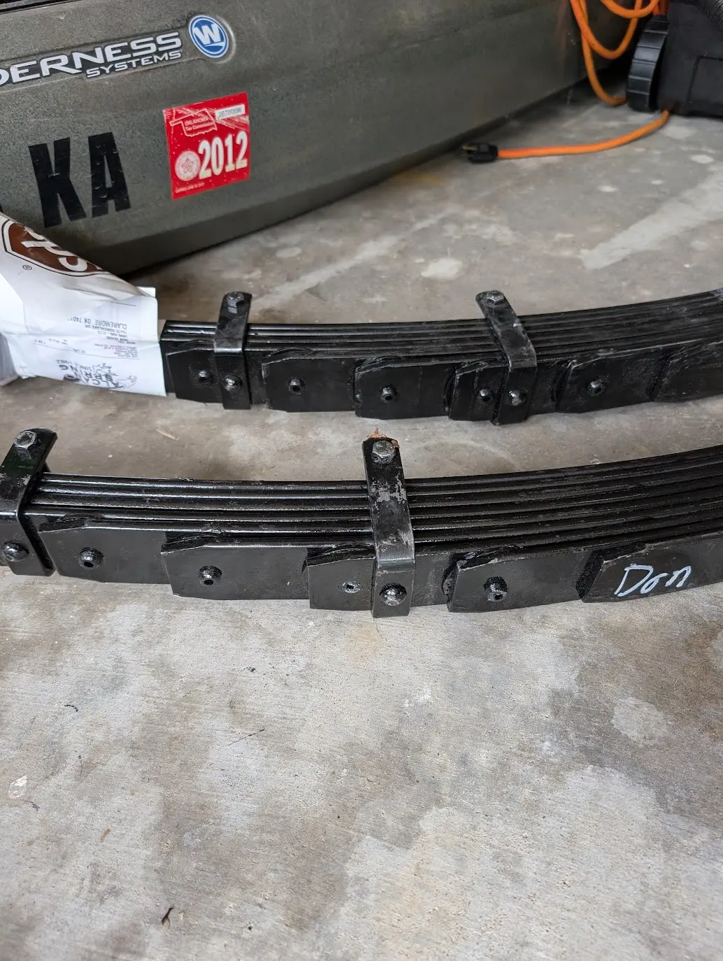

Added the AD mount for the SPod mini, works great and much appreciated on the tip. Thank you!
Should work better with extra weight. What brand and how does it ride?
Alcan Springs made them. Great folks to work with. They are customized for the planned weight of some accessories that will live in the truck bed permanently.
The 35 mile ride back from the shop was a big improvement over the originals. I'll have a better opinion on the ride quality after the recommended break in mileage, which is approximately 400 miles.
