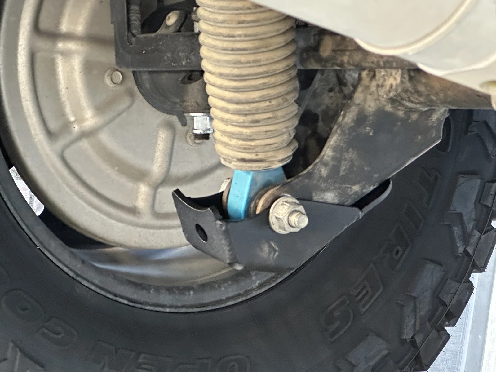

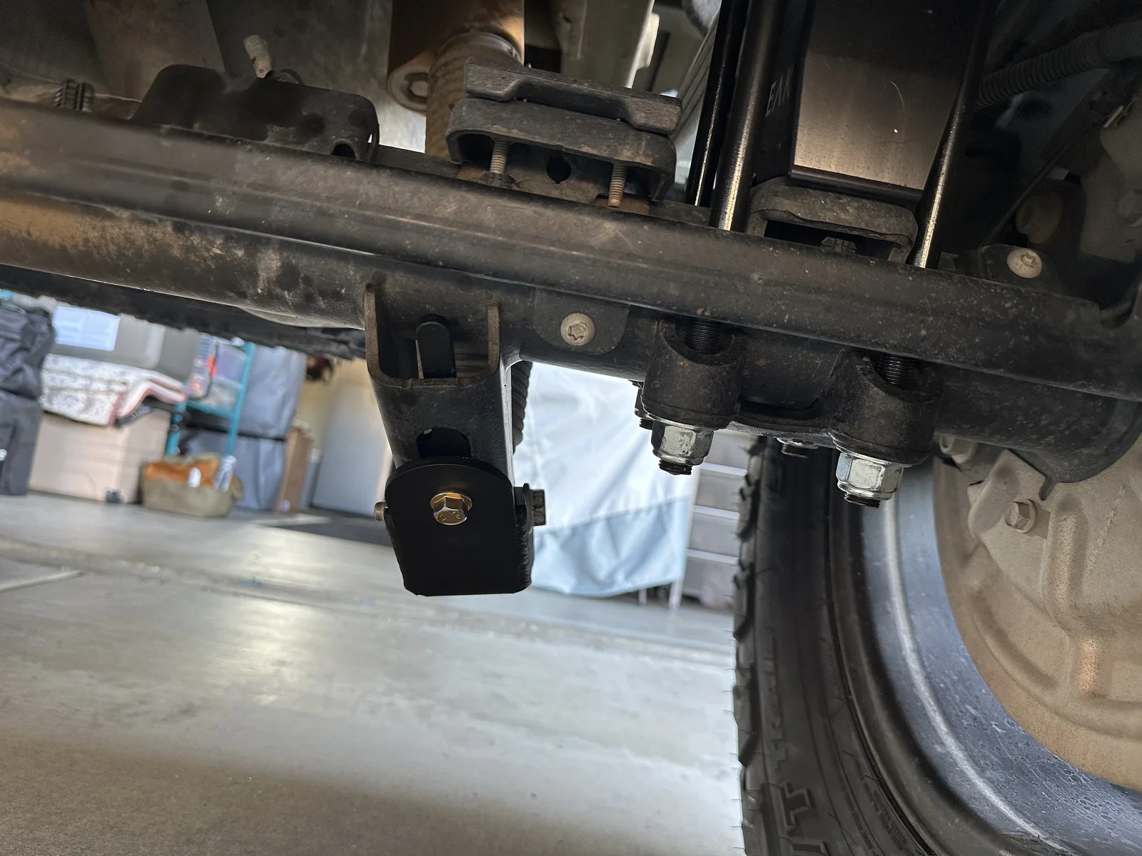

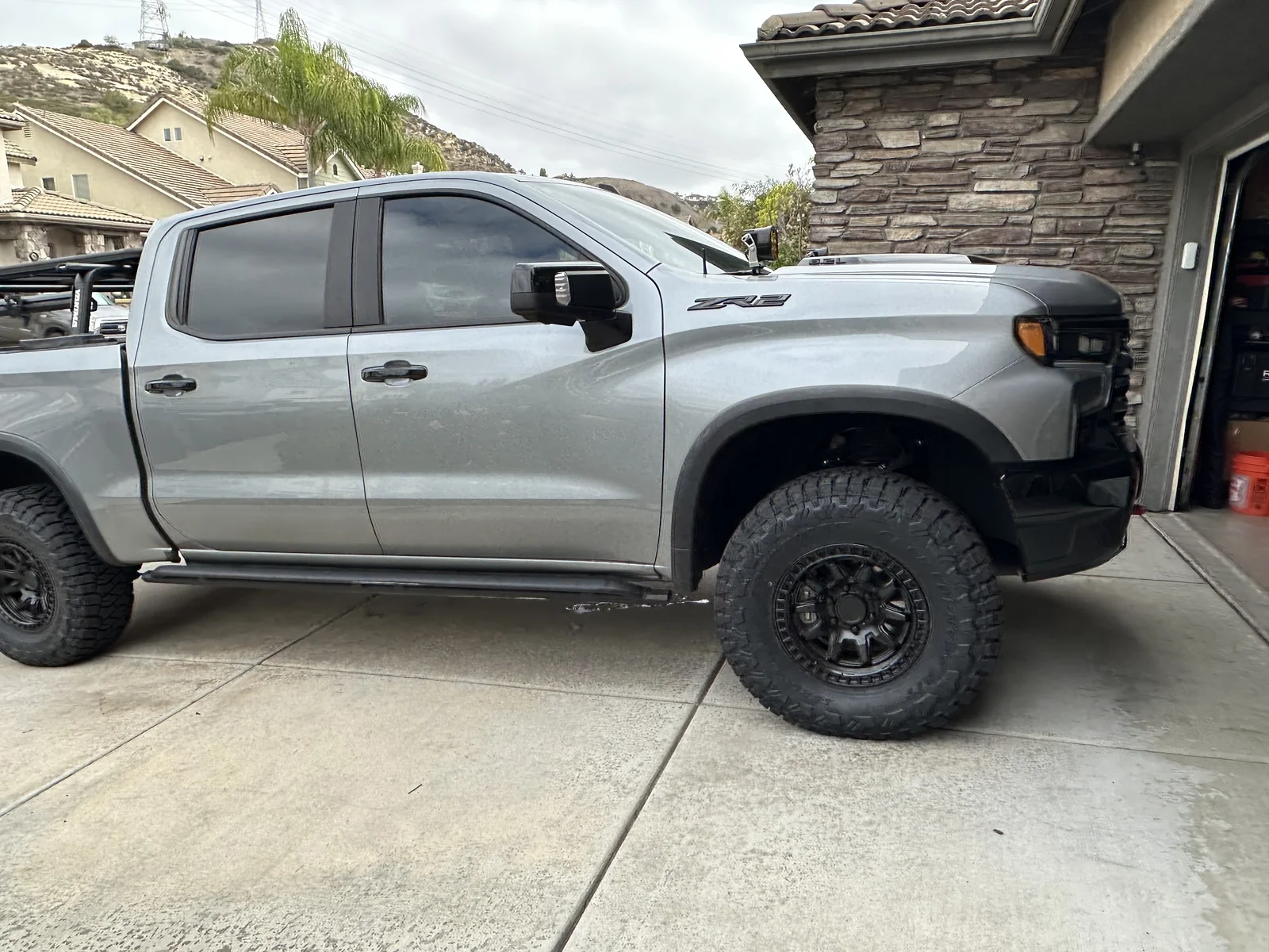

After squeezing in the 35s and performing plastic surgery on the bumper and wheel well liner/plastic, added the shock guards. Hit them a few times before, we’ll see how these work. Also cut the hanging u-bolt ends.

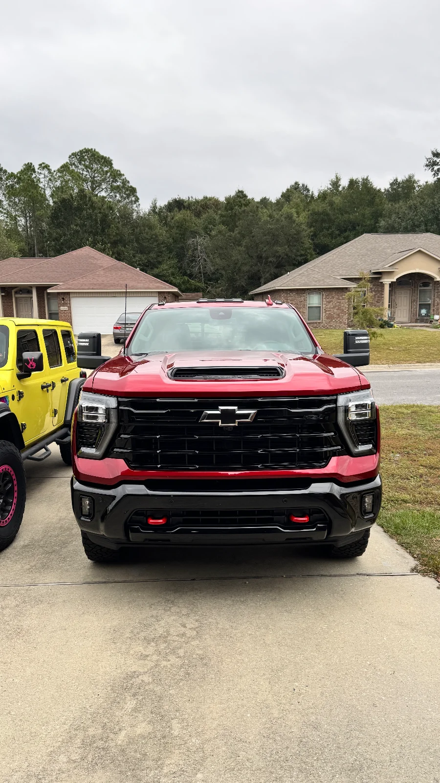

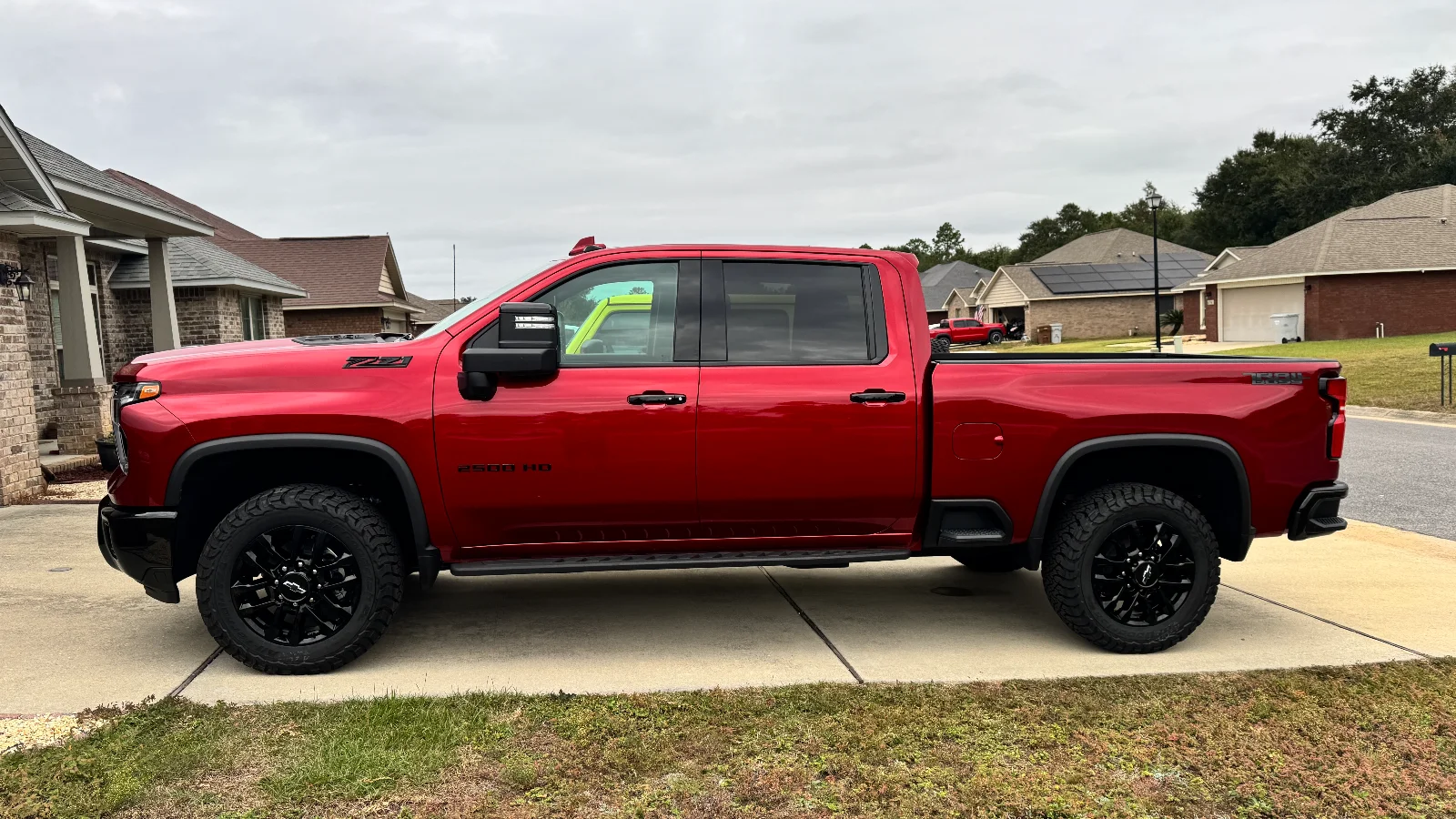

Actually traded the ZR2 1500 in yesterday for a 2026 2500 LTZ Trail Boss gasser. Couldnt get my hands on a ZR2 2500. Love it so far.

Thanks guys. I was looking for the red, black or cypress grey. This was the only one I found that met most of the features I wanted. I wanted the HUD and mirror rearview also but no such luck. Those weren't deal breakers though so I pulled the trigger.

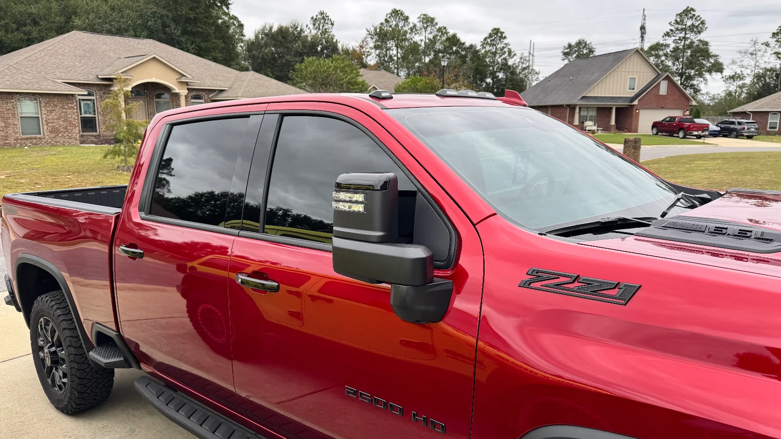

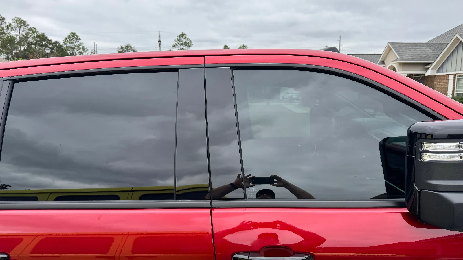

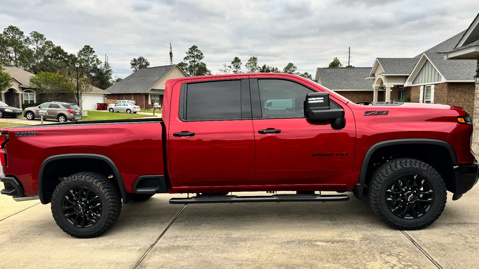

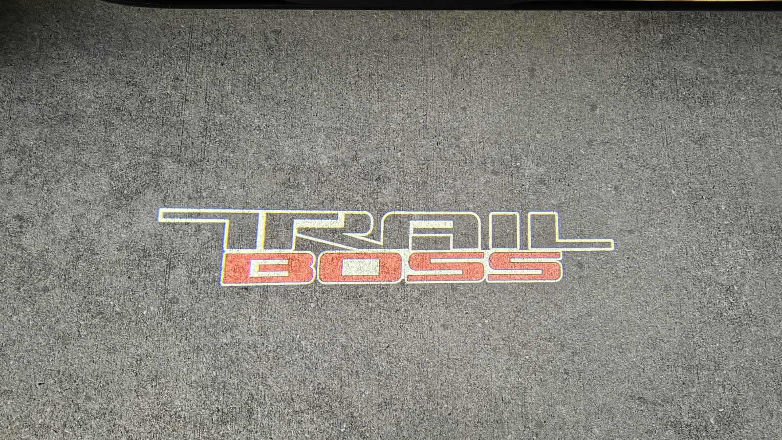

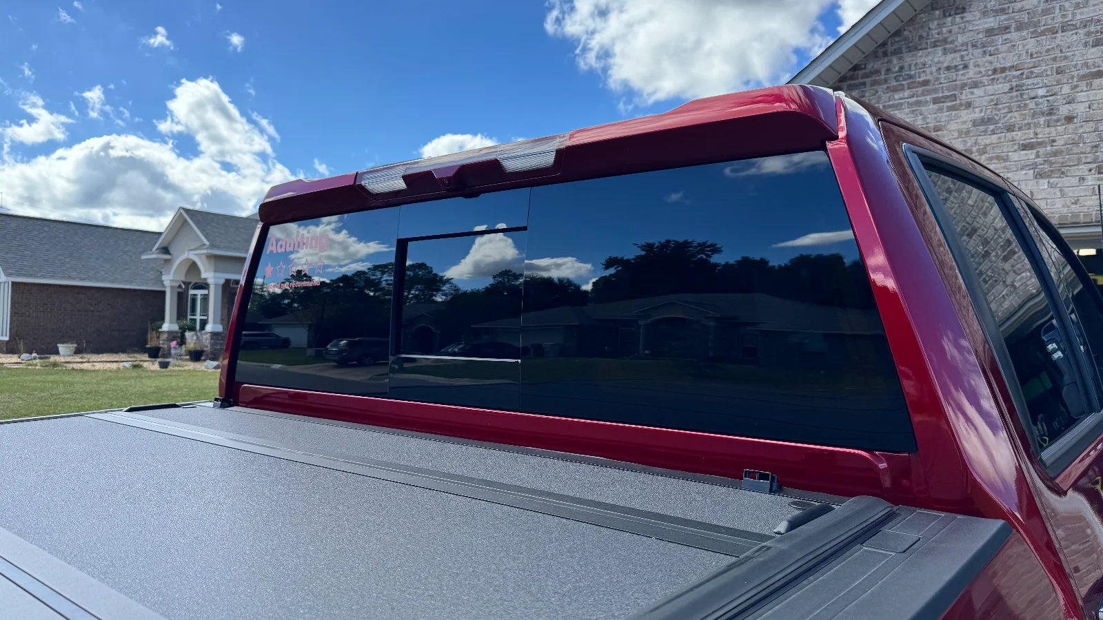

Since getting the 2500 on the 25th, I have tinted the windows 70% up front with a 5% visor, 30% on front windows and everything else 20%. Put on Trail Boss puddle lamps and the reflective window pieces for the rear. Added my vinyl adulting decal to the rear window and changed out the side steps to some that drop a little lower that the high clearance. I added the kicker sub and tonneau cover as well. A few images below.

Stock suspension? How much trimming did you have to do?
I went with the Peak front spacers and collars, 2.5, sway bar relocation blocks and rear blocks. Kept the DSSVs for now. Trimmed the rear portion of the plastic wheel well and removed the lower support bracket. Cut about 1/2” from front bumper and cleaned up the liner as well. Really not a lot of trimming at all, kept it clean but gives me clearance needed for off-roading and full lock left and right.
This kit and lift

Had to get my decal back on the window lol.
