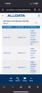

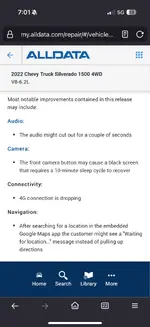

GM’s update’s are not as granular as as U connect or Sync. There’s no website to check releases or any way to manually update with a USB drive.
Just because there is a new version, does not mean it will be pushed OTA. That process to be short and sweet has turned into a nightmare for GM with bricking vehicles.
Most updates are done at the dealer with An MDI if you complain. Otherwise I wouldn’t bet on getting an update.
View attachment 20379View attachment 20380
Latest release seems to address the audio drop out issue tons of people complain about.
The version check is accessible from settings-system-about
