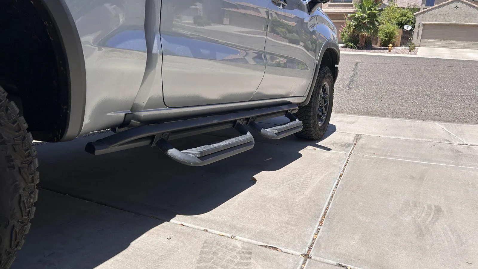

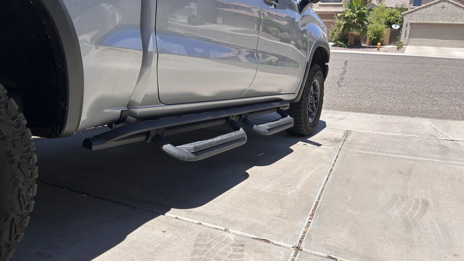

That looks awesome.
Thanks. Fairly straight forward install, but lots of nuts, bolts and washers. EVERY single fastener was loaded with thread locker so its solid. Useful in so many ways!!!
