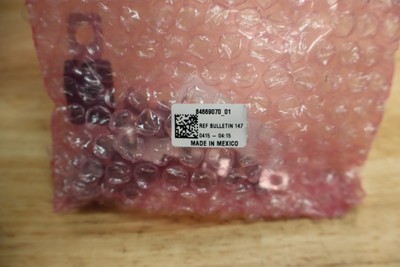

I have done this as well and I used the kit below to provide the necessary power attachment point. In my case I'm powering an anderson connector that I hook up to my trailer to charge it's battery.
You can also order the necessary parts from gmpartsdirect.
84669070 Engine Compartment Fuse Block Kit $48.49
