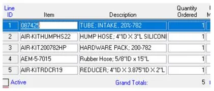

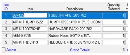

If you call Airaid (owned by K&N) and tell them what you want, they will design it over the phone and you pay for it over the phone....no on-line ordering. These are the parts sent in my confirmation email. Now, please note that I already had an AEM Dry Filter in my OEM box. If you do not have a dry (or oil based if you prefer), you will need to order a filter. Filters are, most likely, cheaper from another source but see what they'll sell you theirs for. I highly recommend the AEM below, but try to find it cheaper if you can.
