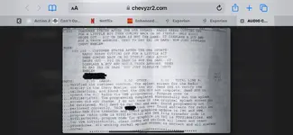

I have a 2022 ZR2 Silverado. Biggest concern was audio cutting in and out during the first 10-15 minutes of driving. Second was not having that special ZR2 splash art on the instrument cluster at start up. The 2023 and up models have them, why can’t I?
I’ve taken this vehicle in several times for the audio issue and no one can help besides “updating software or doing a FR”. The issue remained.
I finally got a master tech who not only corrected all the issues, but he documented his responses that I will post in screen shots. The audio is now FIXED, I have the ZR2 logo on start. I also got an added bonus and the cameras remain on while driving which makes it perfect for off roading and checking clearance. No more timer then the camera shuts off.
I initiated the conversation with the dealer stating the same audio story, but adding that I did have the ZR2 splash and it just went away after an OTA update (even though I never had it). I made it a point to have them “put it back to what it was”. Then the master tech came into picture. Good luck!

Yea I had same issues. Even my ac fan would turn down. Luckily it all stopped. I would try sending the info in the picture I posted to them next time if you go. Maybe that’ll help them
Is your audio still no cutting out since you posted? I just received my rear park assist recall. I’m going take in the picture you posted a see what they can do about the audio.

I got my recall/retrofit for the rear park assist. Disappointed in the service department where I bought my ZR2 after to visits. I called them about the recall/retrofit. They said if they get the parts in they would save one for me. I wasn't happy with there response so I called a dealer closer to me. Very friendly and they ordered my part and said they would look at the radio and cluster per what you posted.

I went to the dealership yesterday 10/19/23 for the oil change and showed my service advisor the post with the download code that was posted on here will re-attach, and so far no audio dropouts. My only concern is will it stay fixed after the next update.
how long did you wait for download? dont forget post RO notes and codes. thanks

Thanks OP, will have them flash this in when I have them fix my trailer brake warranty issue. (y)
