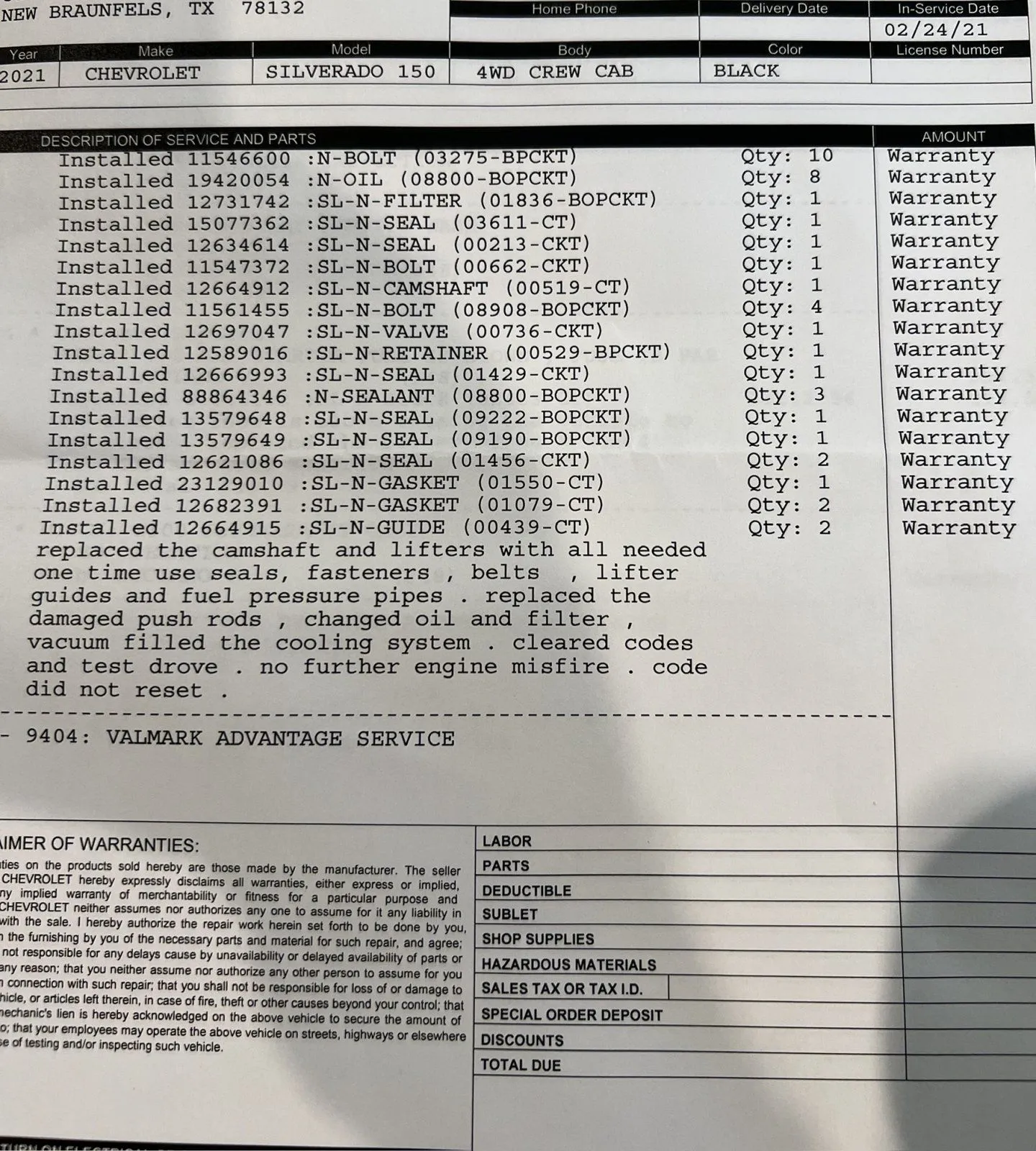

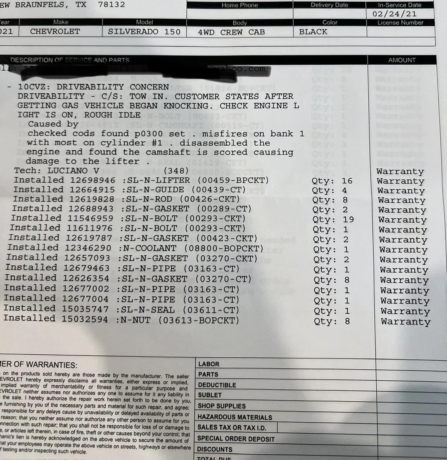

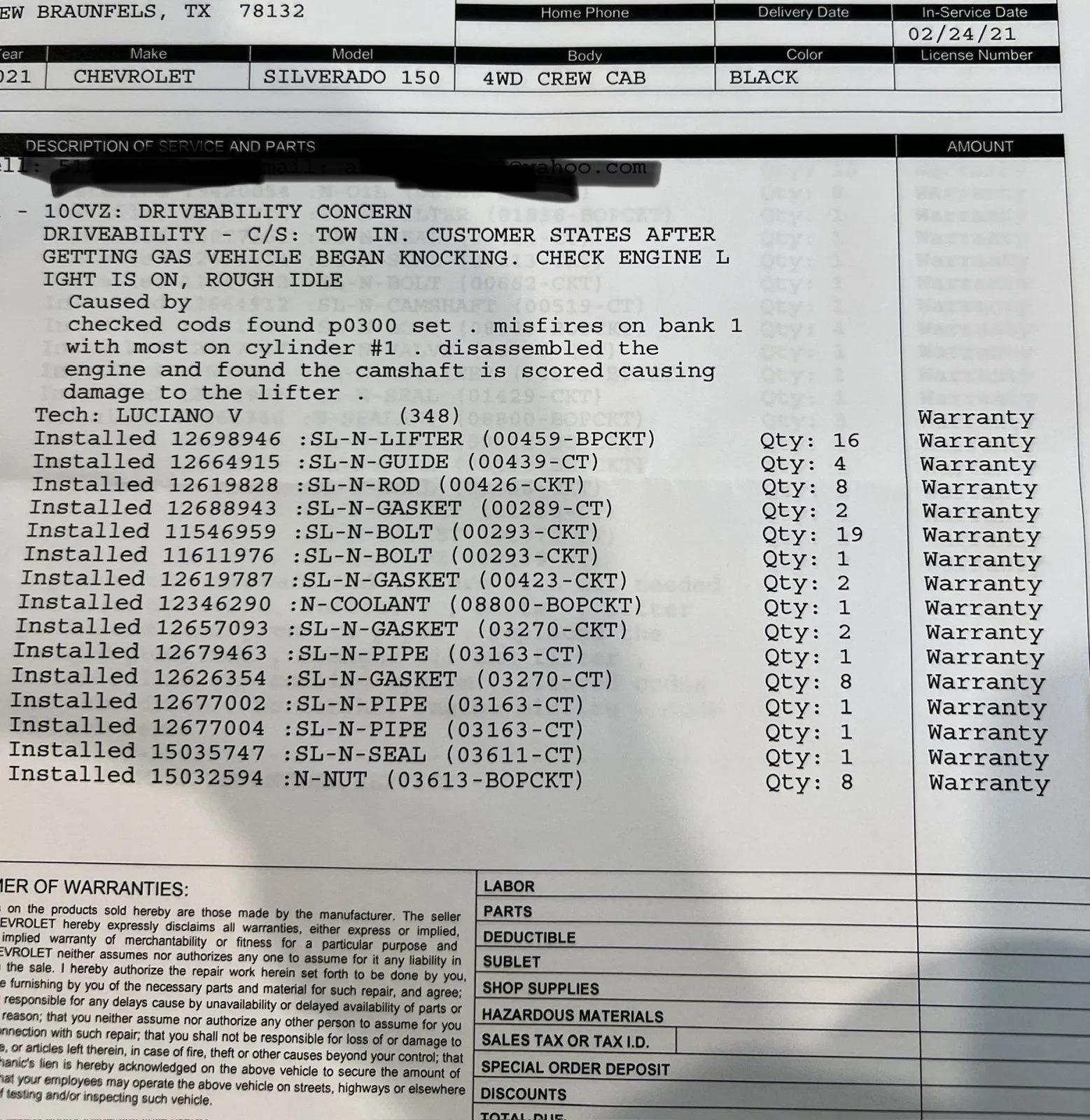

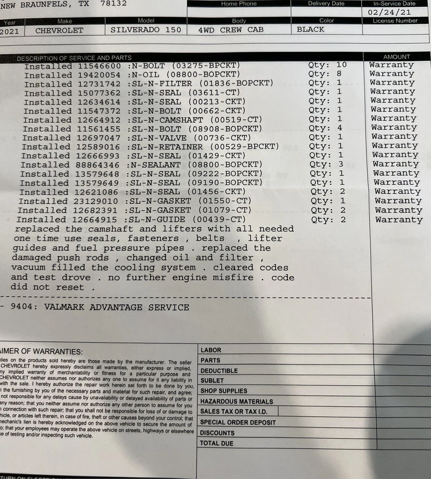

Got my 2021 6.2 back from the shop this morning. Was there 2 weeks and one day. Same thing as y’all. Starting running very rough and service esc, service parking brake and check engine light. 45,020 miles. Report says camshaft is scored causing damage to lifter.
Got my 2021 6.2 back from the shop this morning. Was there 2 weeks and one day. Same thing as y’all. Starting running very rough and service esc, service parking brake and check engine light. 45,020 miles. Report says camshaft is scored causing damage to lifter. View attachment 5970View attachment 5971
