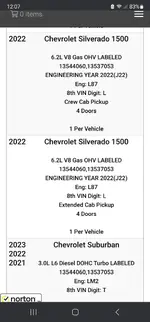

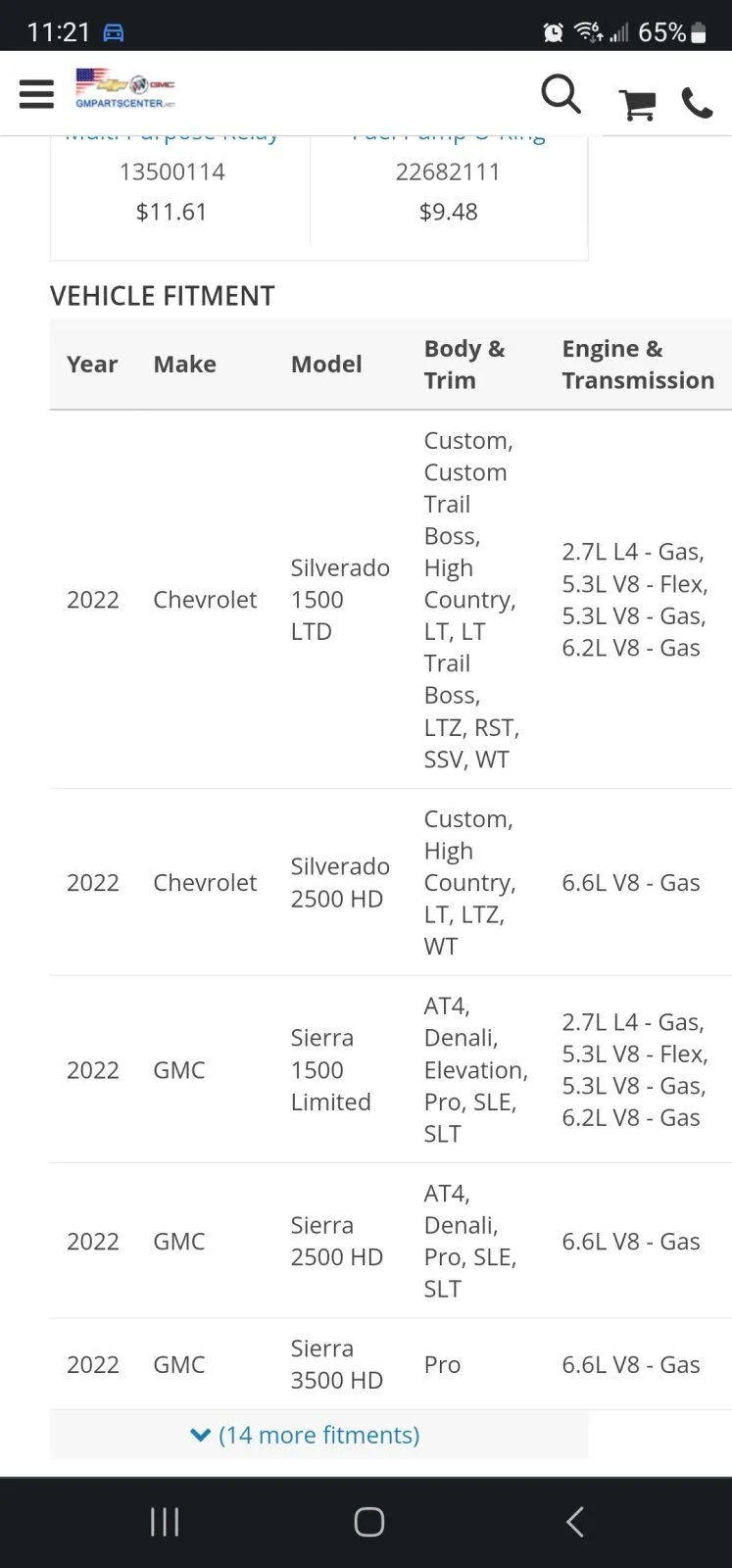

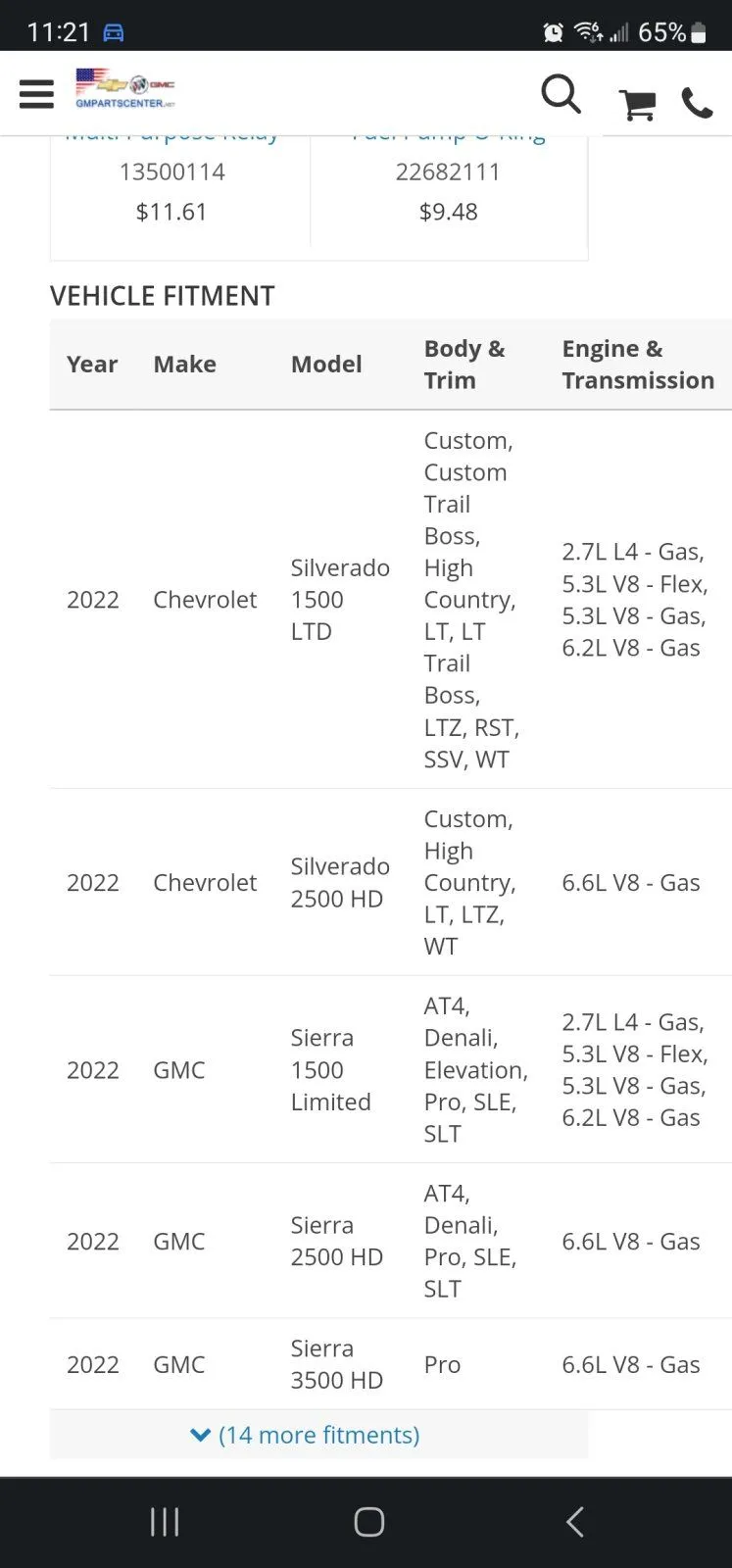

Is the part number 13540028? If so they got them on ebay. If the dealers says weeks or month. He might be worth just buying one himself. Looks like 2 screws and one plug.
i think that # superceeds 13544060
The one i looked up is probably for non refreshed trucks. Ebay does have a single listing for the part number you have though.
i tried looking for a new part. came across few diff #'s that have since been replaced. i found one at canadian gm dealer who said they cant sell to USA. awesome!!!

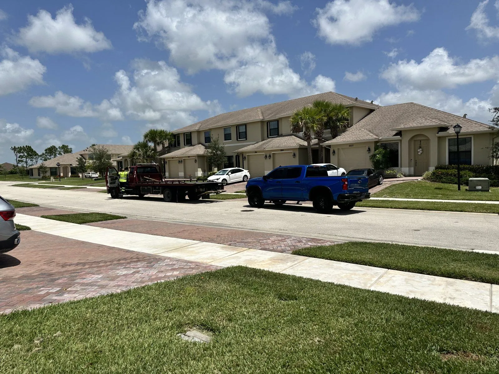

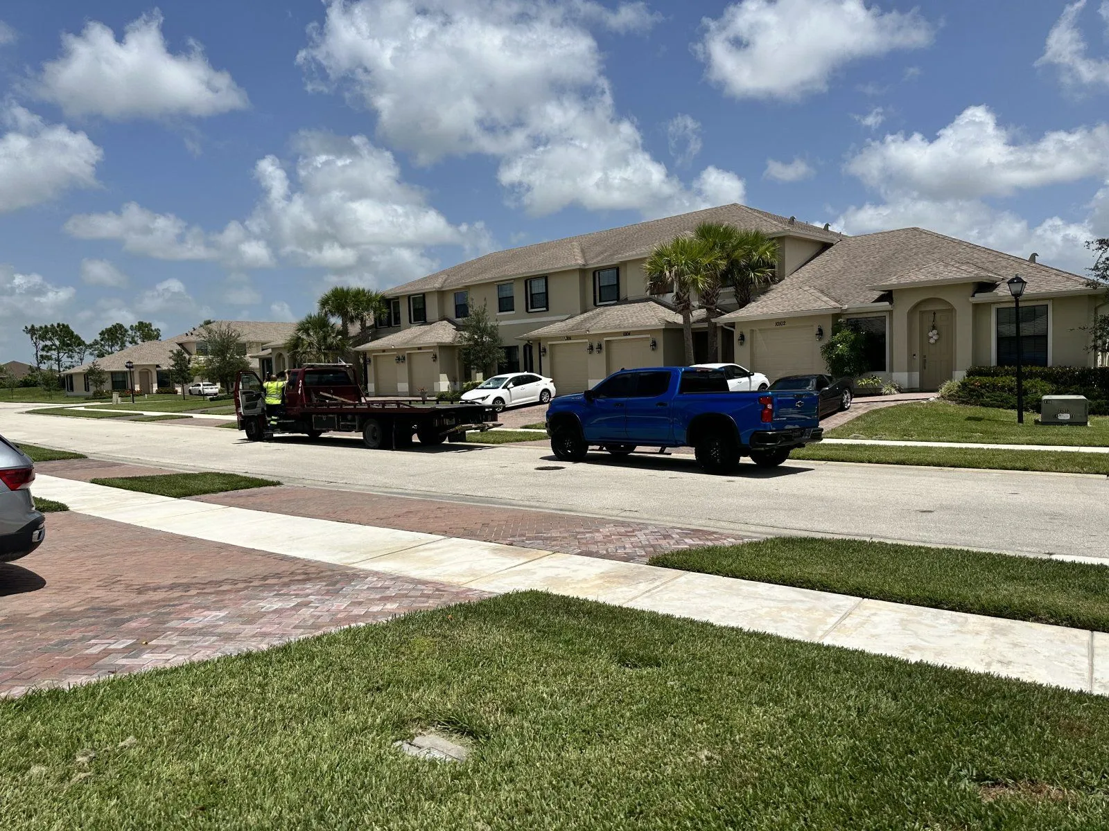

Update. Started this morning and went to drive around block to see how it ran. Stalled and was dead after 3 min. Had it towed to dealer. We will see what they come back with. I shared what i learned in the forum in the past 12 hrs.

So glad when mine went out it wasn't on backorder. It was bad enough that it went out 4 hours from home on a trip. I just wish GM would come out with a way to put the truck in neutral when the engine dies. The owners manual says to use dollies to tow the truck. The wrecker driver that picked up my truck used wood block skies under the rear wheels to pull it up on the roll back. The owners manual also covers GM's butt with a statement if damage is caused by improper towing, it won't cover the repairs.
This flatbed driver used plastic “skates” not dollies. They seemed to work just fine. He told me not many flat bed tow teucks carry the dollies.
