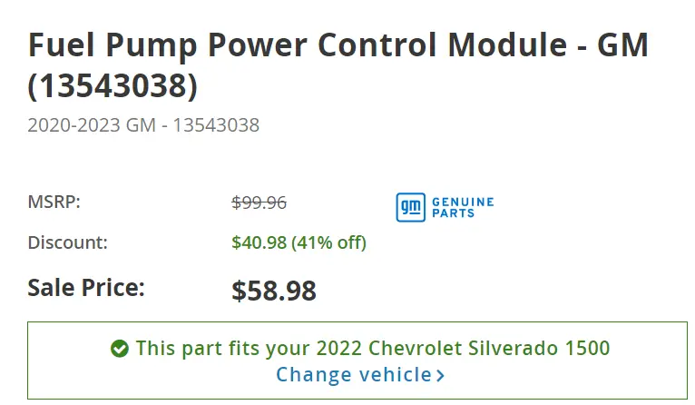

I looked up part number on GM Wholesale Direct for the VIN on my truck 13543038
Be advised, just because they list it, doesn’t mean it’s in stock.
Orders to GM are actually restricted by VIN currently. It isn’t typically an “off the shelf” part unless you win the lottery.
There’s a way. It requires a tool to release the transmission manually. There is no user override however.

Dealer confirmed it is the FPCM, on back order, no ETA. They are getting me a loaner a Ford F-150!

Talked to my service advisor today. My dealership has not seen a high volume of these failures but did replace an FPCM last week. He told me it took 2 weeks to get the part from GM. Hopefully yours won’t take that long.
Hmmmmm, I got the same year as you but it call for part number 13554821 as per my vin. Just wondering why would they use 2 different part numbers on the same truck, same year, same motor ??? As you can see from the images, I actually went under my truck, loosened the part and got the number from the actual part which is 13544060 but is superseded by part number 13554821.

The new number may actually be an updated part. I've seen that before.
Yep, that's exactly correct, it's an updated part number. I was wondering just for added measure, should I order the part and go ahead and replace it and save the original one as a spare ?? From what I've read it's a plug and play part and no programming is involved. What are your thoughts ?

I know what you mean. I went under my truck and pulled the module to get the actual part number(checkout my images). BTW, it's held with two 10mm bolts. You'll need a short 10mm socket 1/4 inch drive with a small ratchet. I went ahead and ordered one today for 82.00 dollars with an ETA of 2 weeks. Let's see what happens.

I looked on myChevrolet smartphone app today and it gave this part # for the Fuel Pump Power Control Module. # 13554821. Which is same as SeaHunt has in his post.
