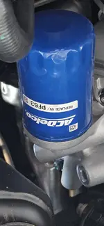

I was crawling around underneath my rig today and noticed the 2500 HD ZR2 uses the same AC Delco PF63 filter as the 1500 ZR2. That seems very small for a big motor with 2.5 gallons of dirty diesel oil that might run extended intervals for guys that use these for work and cover a lot of miles like hotshots.
I will do 5K intervals, but may switch to an extended performance synthetic or longer filter. I've cut these PF 63 filters apart and they have a lot of media, but it doesn't seem like enough. Also I think the wall of the filter can is a little thin.

That is pretty interesting, seems like a lot of volume for the same filter.

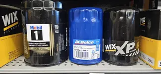

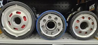

I went to O'Reilly at lunch. This is the Mobil 1 M303A, AC Delco PF63 and Wix WL10255XP side by each. The M1 is 30% larger, but I don't think it would fit the new small mount.

I went to O'Reilly at lunch. This is the Mobil 1 M303A, AC Delco PF63 and Wix WL10255XP side by each. The M1 is 30% larger, but I don't think it would fit thos new small mount.
I would go with the Mobil-1. I have used them a lot in prior vehicles.
The compatible Mobile 1 filter is the M1 212A. I was gonna use it on the 1500, but it is so small it looked like it belongs on a lawn mower! I won't use it for that reason. They are otherwise good filters and you can get them for $10.
The 303 looks enormous next to the other two. That is a small space they have now. The filter housing looks like part of the pan.
Yeah, there's also a hose hanging at bottom end. Much longer and you might not get it in there.
