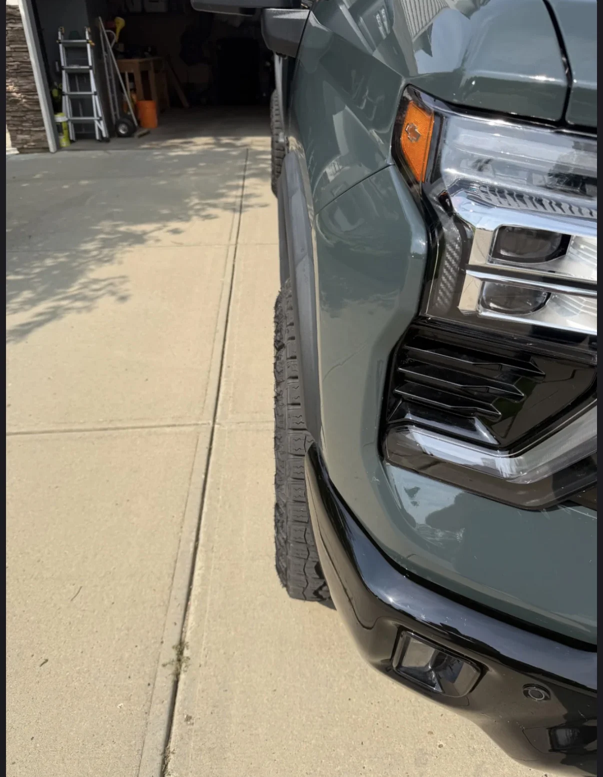

I just went with some 0 offset rims and put the stock tires back on. They don’t stick out a noticeable amount or anything. Minor rubbing in reverse with the wheel cranked. 37’s @ 0 will probably need some trimming.
That looks pretty good! With a 12.5 wide tire, might be what im looking for. I figured I'd get the AEV trim kit for 37" and probably 2 or 3 turns on the torsion bars. Was going to go with a smaller 37 option like the BFG K03 or a Recon Grappler there 36.5".
I think the stocks are basically a 12.5 inch tire. Some rough measurements with the stock tires on those rims to some 35x12.5 winter tires on the stock rims and I think they’re quite close width wise
