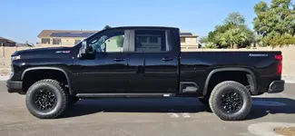

I spent 15 minutes under mine with socket and ratchet on the torsion bar key. Measured it on flat even concrete. Set mine just a tad lower in the front, since it wasn't raked much anyway.
This picture was my final setting after a couple different settings. Rides great! I got a detailed post about it.

On the ZR2, it's about 1.5 inches rake, so I went about an inch and did like 3 turns on the bolts. I tried 4 turns and full level, but did feel it might have been a tad stiffer. I think the Multimatic DSSV suspension does a good job of masking the issues caused by stiffening the torsion bars a bit.
here’s 37” 12.5,20 with 4 full turns alignment was very close but I did have aligned when tires were installed and rides awesome both on and off road and tows still bad ass
Looks great! Is that a -18 offset?
