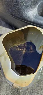

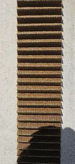

I changed oil on both my wife's 6.2 L Tahoe and ZR2 at 1500 miles. Here's what I've learned.
  • Filter is constructed well with a lot of filter media.
  • Oil was darker than expected for 1500 miles.
  • Filter was doing its job well.
  • Oil had a fair amount of gray sludge visible in drain pan from metal wear.
  • Filter media had collected plenty of metal shavings deep in the pleats.
  • I personally always change oil early first time and stand by that decision based on what I've seen here.
  • Oil change is pretty clean and easy. Oil drains fast and well from drain plug. Filter will drain some on the sway bar and drive line support. Filter is set up in there and a little hard to access especially when hand tightening if you have big mitts.
  • I love changing oil and cutting open filters.

The lighter filter media is from Tahoe and darker media is from ZR2. You can see the metal debris pretty easily.

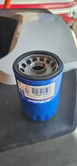

Did a 15k oil change on my wife's Tahoe 6.2L. There was 5000 miles on this change and the oil life was 33% in DIC.
Mobil 1 0W20 still looked and smelled good and color was brown/gold. This is after the hottest summer on record in Phoenix, where we broke 14 extreme heat records.
Cut the filter apart and inspected the media. It looked really clean. Only seen a couple tiny silver particles. Might be able to see one in this photo.
I noticed the design on the PF63 filter was changed again. It has more holes in the base for better flow characteristics, but seemed lighter and lower quality.
Sent an oil sample to Blackstone Labs for analysis, so I'll post it in my lab results thread when I get it back.

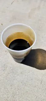

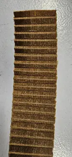

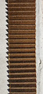

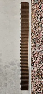

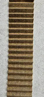

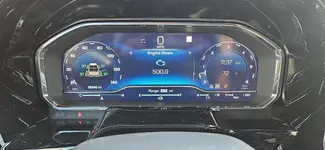

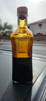

Changed oil on my 1500 ZR2 at 13,333ish miles and 500 engine hours. That's my new 3333 mile change interval......LOL. I've decided I like the look of the oil and the laboratory analysis just a little better, so three changes per 10k.
Oil looked pretty good and felt clean. I collected the oil in two 1 gallon distilled water jugs so I could pull a sample to send in. Also wanted to see if I had a full 8 quarts. I did add about 1/2 quart at 2500 miles, but it drained 8+ quarts out I use a little bit of oil, probably cause I run it through the gears in higher rpms occasionally. I noticed a little bit of light copper colored film on top of the oil. Didn't feel like much, not sure if it was contamination or air bubbles as shown in the picture.
The filter looked really clean, just a few small silver specs visible. Also seen what looked like two small grains of sand in there, but it sort of looked like something from the filter when I cut it off the base. Never seen that before.
I'll post the oil analysis in the oil analysis thread I started in a few weeks when I get it back.
