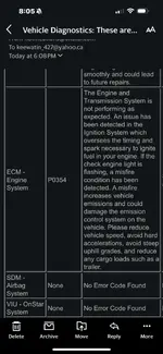

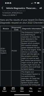

Well… I just got another Check Engine warning and rough idle. It shut itself off after remote start, then when I was inside it started and idled rough and stunk like backfire. Immediately contacted OnStar and got the diagnostics emailed to me. Tomorrow I limp into a local dealership and see what they can do. I have a feeling this is veering into lifter failure territory.

Update; it was a faulty coil pack on cylinder 4. They replaced it so hopefully no more issues. I also got the rear fender liners I ordered when I first bought my truck in 2022. Nothing like waiting a year and a half. They look great at least.
