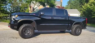

295/70-18 these are 1/4” less diameter than a 35 And 3/4” narrower. They’re on 9” wide wheels with +1 offset. Fit great with a 1-3/4” level kit/UCAs and no rubbing.

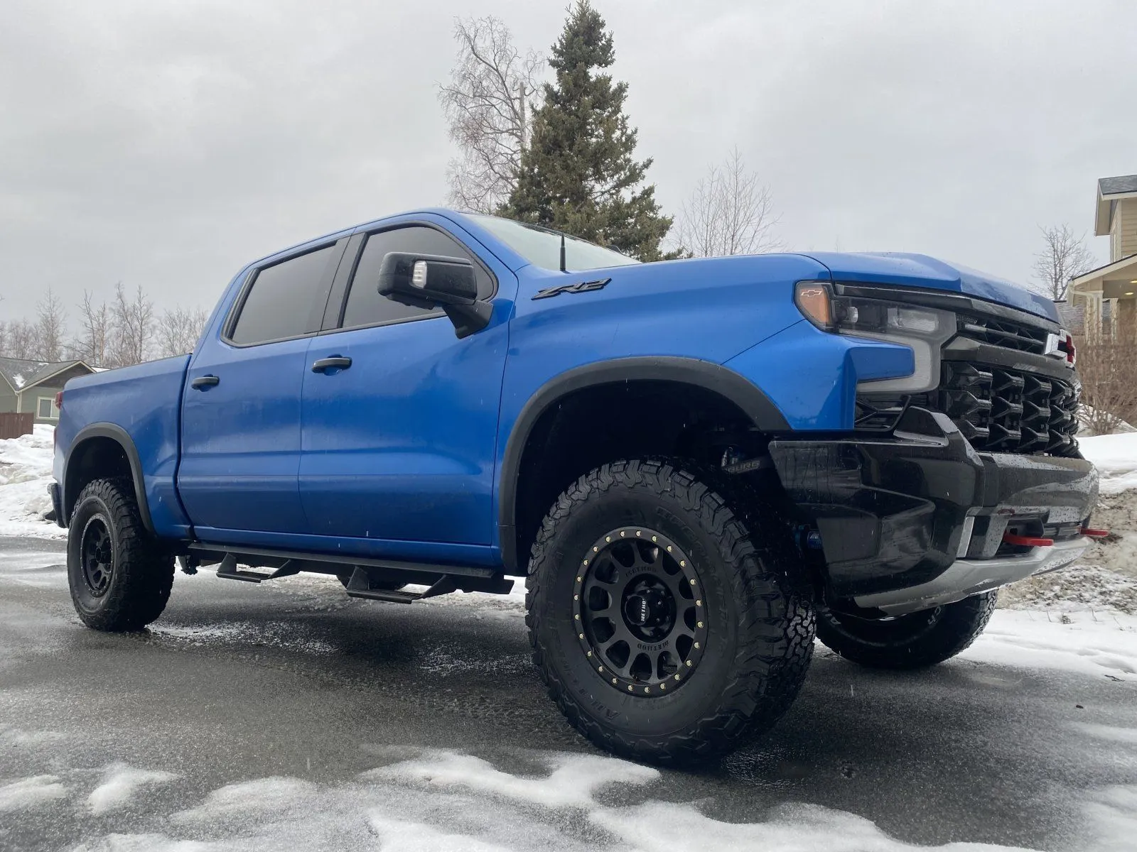

Very nice. I’m running same exact wheel & tire setup, except w/ 1.5” leveling kit. I’m rubbing a tad in rear and on front bumper end, more so on passenger side. Looks like that additional height makes a difference. It’s a game of millimeters. Pushing out bumper 1/4-3/8” will probably be enough. Not sure I want to cut metal.

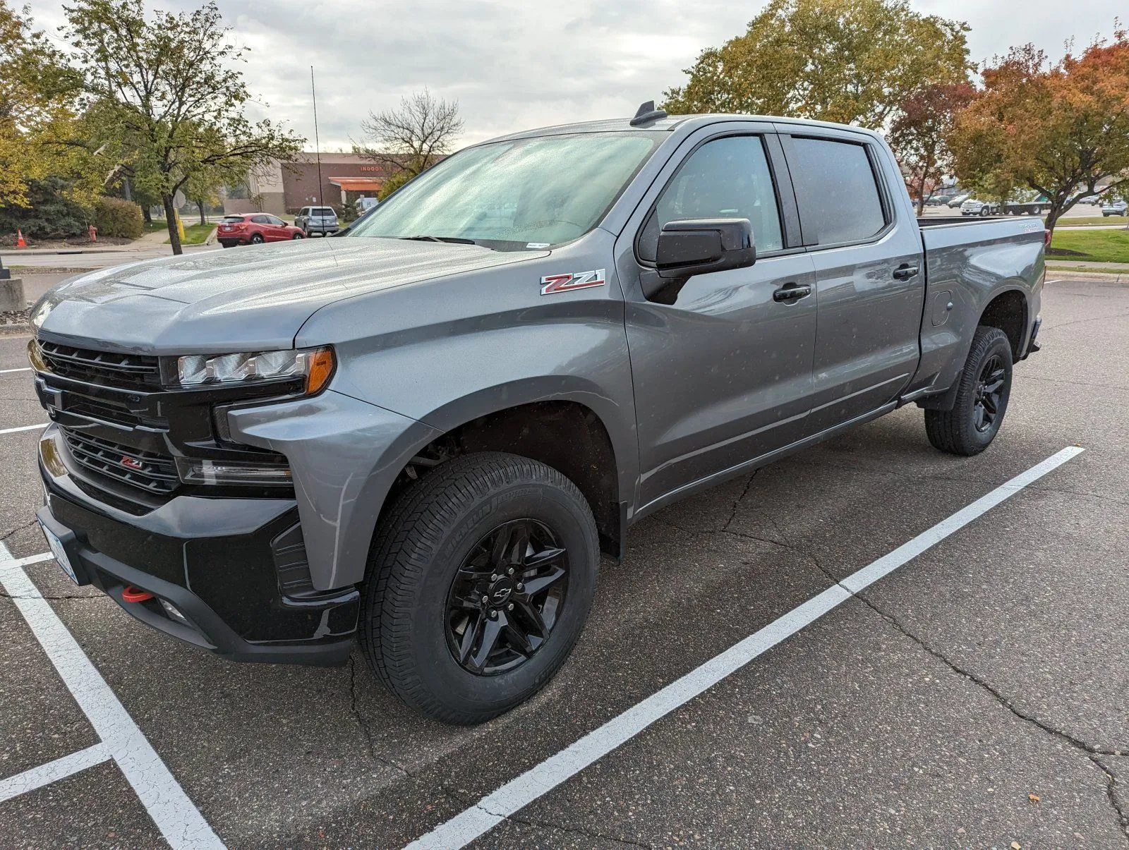

I ended up going with the 275/70R18 Michelin Defender LTX M/S2 and I couldn't be happier. They are SILENT on the road, and they fill up the wheel well a little bit better. They're definitely not as aggressive-looking, and I'm looking forward to seeing how they do in the snow this winter.
I ended up going with the 275/70R18 Michelin Defender LTX M/S2 and I couldn't be happier. They are SILENT on the road, and they fill up the wheel well a little bit better. They're definitely not as aggressive-looking, and I'm looking forward to seeing how they do in the snow this winter.View attachment 7860
I've run a few sets of those on my wife's Tahoe and a work truck. They are one of the best tires made. Had really good luck with them.
