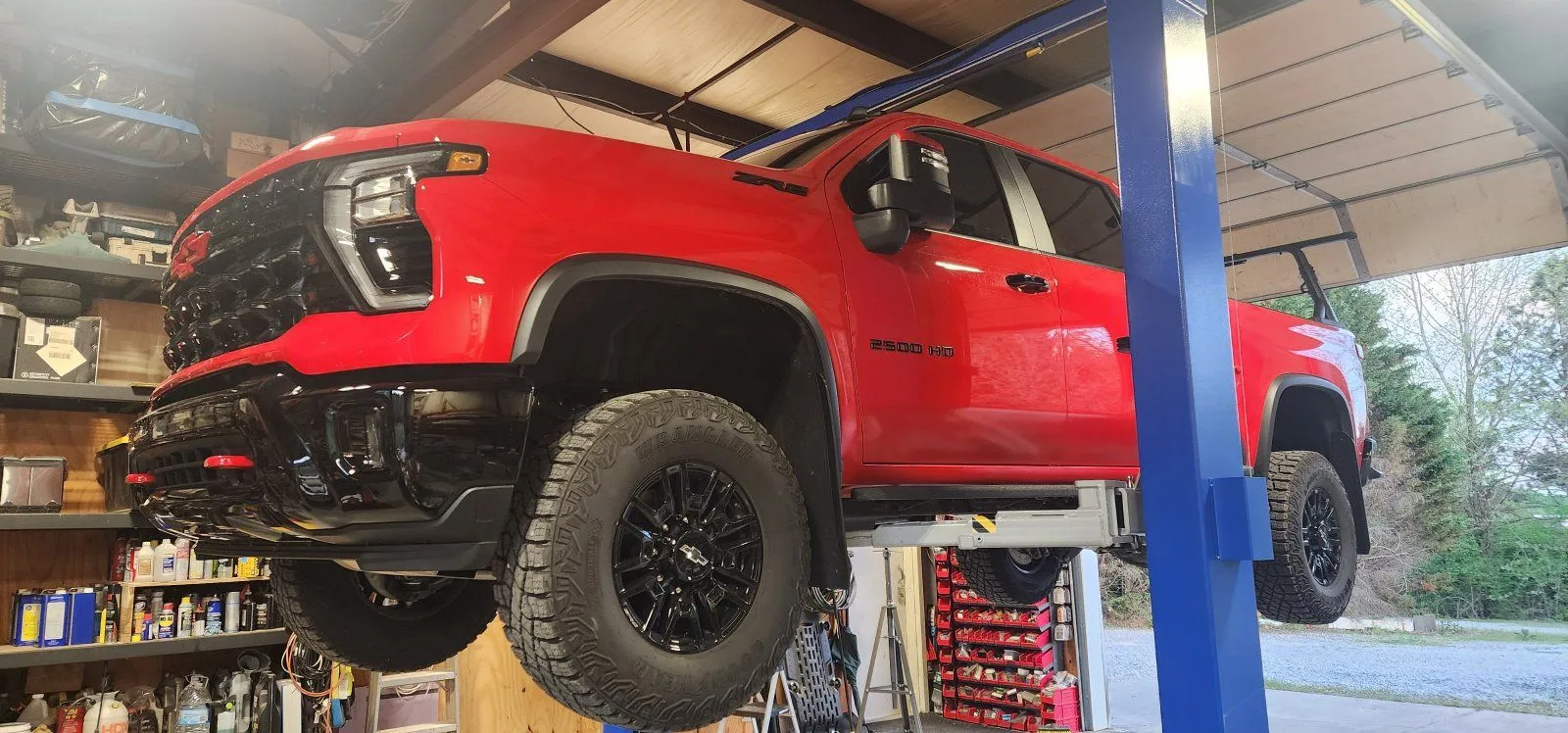

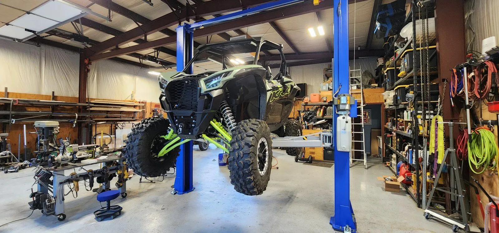

I should have bought a lift sooner. I've already used it a bunch. Had a buddies suv on it yesterday and had my mother n laws car on it today. My ZR2 has been on it a few times already. My SxS and both my sons trucks have been on it, lol. The thought of Using floor jacks and jack stands now just seems like a hassle.

I went back and forth on that choice a little. It depends a lot on what you mainly want to do. For just oil changes exhaust and some general maintenance, 4 post is good. I've got a buddy with one and it's simple and fast to drive on and lift. Down side is they are more trouble with tire and suspension work. A 4 post also limits access a lot. Especially once you add roller jacks to them.
For me I wanted to be able to pick up a SxS or a quad and still lift my truck. I also mainly want to lift the tires off the ground. I rotated my tires on the ZR2 yesterday before I did a oil change. Stuff like that is just easier on a 2 post. You lift the truck just a little and pop off all for tires onto the ground. On a 4 post with rollers. It's much harder to do a simple tire rotation. Especially with large tires.

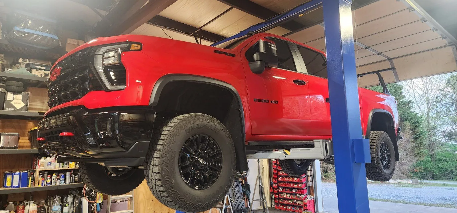

View attachment 13038View attachment 13039

When I got my lift I also picked up some frame cradles. They replace the pads on the arms. Basically a steel u shaped pad that cradles the truck frame. No real way for the truck to slide off the arms. I also picked up some under lift stands. You don't really need stands for basic stuff like a oil change. If your going to be shifting a lot of weight or really wrenching on something they are good to have. With a stand in the front and rear the truck is rock solid up in the air.
2 post needs about 12' infront of it from the wall. If I had a single door shop. I'd probably just put the lift in the back close to the back wall. With a 50' building you could easily have 36' or so between the lift posts and the door. That way everything you pull in wouldn't need to go between the posts. With 50' you could have something on the lift and still pull your truck in behind it.

With a lift you just pull in swing the arms under and push a button, lol. I added a arm braces to my SxS. Same deal. Instead of putting it up on stands to pull all the suspension bolts. I just put it on the lift in one step. Of course if you need it, is one thing. But man does it make stuff easier and faster. The work is the work vs just getting it ready to do the work being a job by itself.
