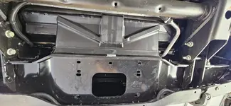

Here's some photos showing the frame on a 1500 non Bison. It a real project removing the front fascia. Others have posted pictures and some YouTube videos of winch installs and that might help you come up with a plan.

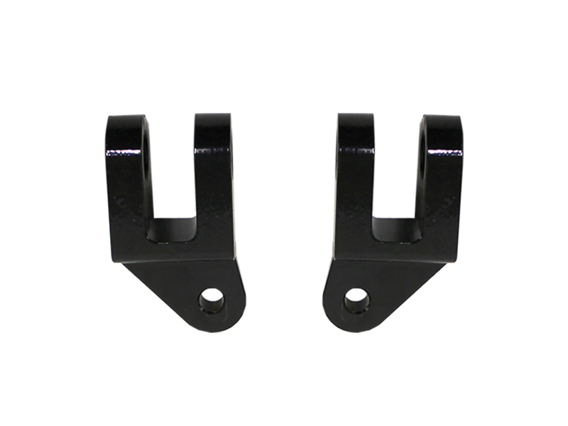

This is what is offered on non AEV bumpers, was hoping they may line up with the inset areas

Those look really nice, but I think the Bison bumpers are mounted into this same spots in the frame. The tow hooks may be the best option and should accommodate flat towing with some type of fabrication.

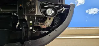

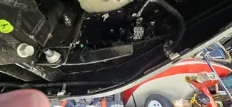

Here's some photos with the skid removed on my 2500HD. You can see how the bumper goes into the frame. There is room below the bumper mount. But you'd have to cut out or remove the skid plate and come up below the bumper. I think that would look janky.
Found these that are made to attach to most jeep off-road bumpers in 1" and 7/8". Can chance you would mind measuring the tow hooks for me? Thanks for all your help and advice.
