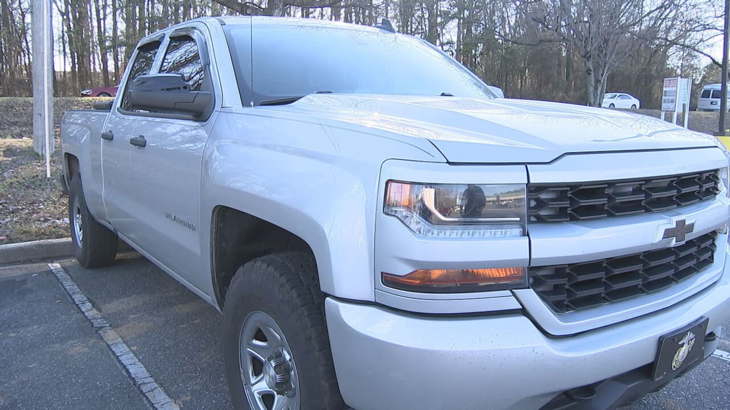

I don't know if anyone else has experienced it, but when I'm at a full stop and the "auto start/stop" feature hasn't kicked in, I definitely feel the truck "shudder". Intermittently, not constant. Not forcefully either, but enough that I could definitely feel it.
I also had an experience during the winter when this happened to a greater degree until the engine light came on blinking and I had to send it in to service a bad fuel injector. Apparently if your engine light is blinking and not solid, pull over immediately and get your baby towed in as it is deemed unsafe to drive at that point.
My truck currently has 2200 miles on it and was purchased brand new off the lot in September.
