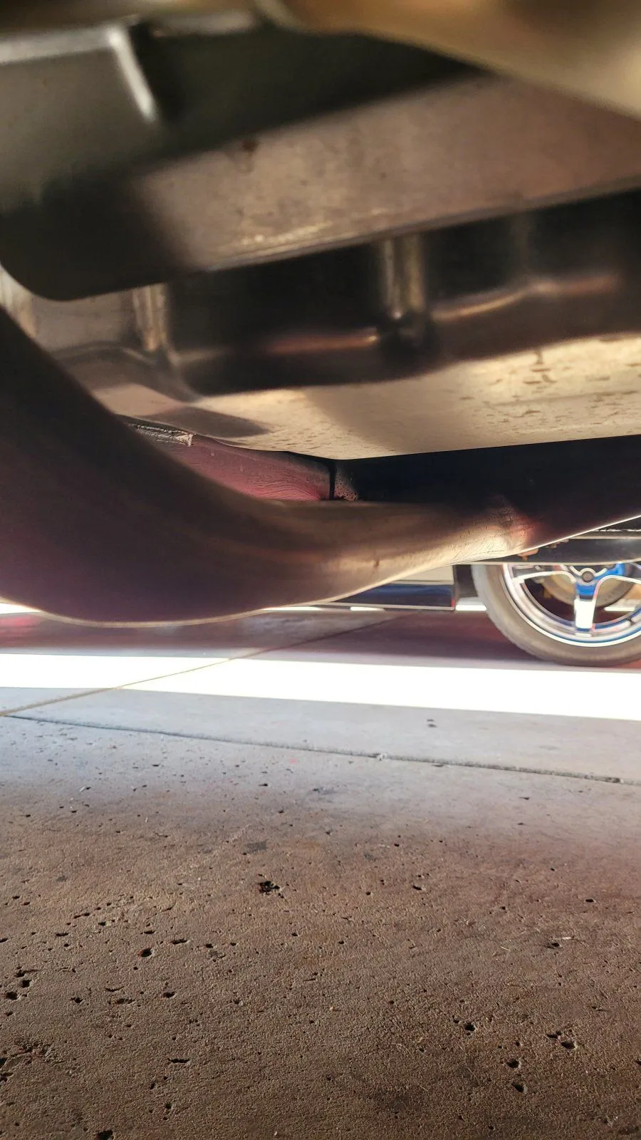

So today i had the crushed section of the Y pipe cut out and replaced with 3” stainless and the results were it woke up my truck,the acceleration is spot on 100% better,the engine breath’s better and is not working to compensate for the restriction in the former driver’s side exhaust.The Borla sounds much better now!I highly recommend this modification!

yeah i’ll get some.It’s more of a function over appearance thing with me but anything was better than blowing the driver’s side exhaust valves over that crushed pipe that GM says is for clearance.I firmly believe that that crushed section of the Y pipe is what burns out the lifters.

The replaced section of the crossover piece does not hang lower than the front axle.Just an fyi.

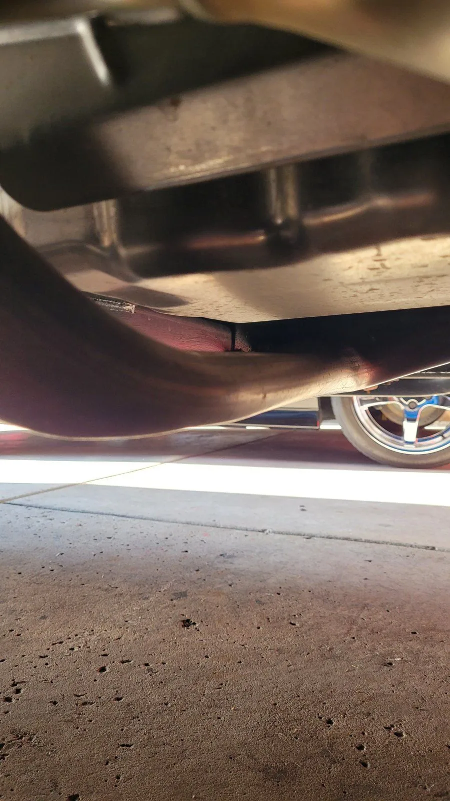

There is another reason the crossover pipe is flattened, and that is to keep it away from the transmission pan. As close as your 3" pipe is to the pan you will want to keep an eye on your transmission temps. Here is a picture of the factory set up on my truck.

yeah,I know and that was a concern.The pics don’t show the gap above the new crossover very well.It is a 1” gap.The tp of the new crossover was flattened somewhat before installation.The difference in how the truck runs now and how it ran before are like night and day.NO throttle hesitation at all and very responsive.The engine runs 110. % better and can finally breathe properly.

Well,I just drove it at highway speeds with some pedal to the metal so to speak,for approximately an hour and 1/2.The outside temp was 20 degrees celsius since i am in Canada and the trans temp never exceed 74 celsius with it dropping a degree or two a few times when laying off the gas pedal at cruising speeds.
