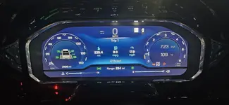

I get what Huntredi is saying and that makes the most sense. As far as the braking, I had a 2017 Chevrolet diesel High Country that high idled a lot. Both of these trucks braking acted the same way when they idled faster. It’s like the higher rpm’s and momentum just make the brakes feel sloppy. Just so you don’t think I’m a good, I’ve included some pics from today at a full stop at lights.
The first one is this morning around 8:00-8:30p at 89 degrees. The second was at 2:00p at 104 degrees.

Here's mine at 730 pm at 109°F at about 750ish. Here's one at 68°F st 300 pm at about 650ish.
