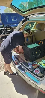

My boy helped the neighbor kid install a kicker sub in his 2006 VW Toureg. That vehicle was a giant PIA to work on. Battery was under drivers seat in a sealed box. Trim was hard to remove. Carpet was attached to floor so couldn't get the wires installed.
Finally got it and it sounds good. They did a pretty good job. Gonna clean up the wires, shorten them and get some better connectors to attach into the amp.

In some ways it was solid, but holy shit it was hard to pull trim. Carpet was 1.5 inch thick foam backed. Had to pull the front seat to get to the battery box. It's a V8 smsl SUV, so no room under the hood I guess. Wasnt really my project, but I had to consult on it.

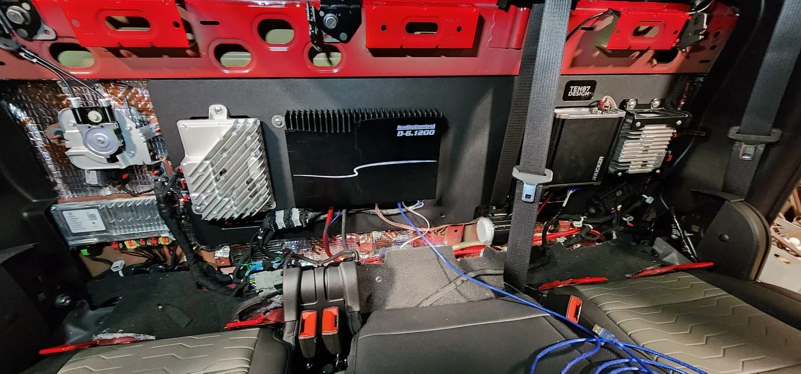

Yeah I don't blame them. I tried to source the bose connectors with no luck. Probably have to order 1k min of them from some random supplier. Plus they hand make them to suit your needs. That was more the reason I did my own. It was the 3 week plus lead time for it to ship. I ordered those plugs for 30 bucks and 2 day shipping. Took maybe an hour wiring everything up.
End of the day it works great. One plug is output from the bose amp, the other is inputs to the speakers. My harness has matching plugs. One is inputs to my amps other is outputs from amp. Or I can just unplug my harness and plug the factory wires back together to put it back stock. The factory Sub wire is separate. I did that on purpose so I could unplug the factory sub while I was tuning or setting the gain on my sub amp. Something that's hard to do with the bose integration harnesses.

I appreciate it. It's really not bad to do. Seems a little daunting at first. That's why I tried to share what I did. I didn't really know what to do and couldn't find much information on refreshed trucks. I just sort of fumbled through it with trial and error, lol. I did my 1500 and everything worked. But on the HD, I had a better idea of what to do and how to make it a little cleaner install. Especially after having to take everything out of the 1500 quickly. I tried to setup the HD, so it would be easier to remove everything if I needed to.
The amp wire under the cab, plugs at the bose amp. Everything mounted on the back wall out of the way. It all works well and seems like the easiest way. Other than the way it sounds. Inside my truck looks all stock with just a oem sub under the seat. I don't think I would do anything differently.
