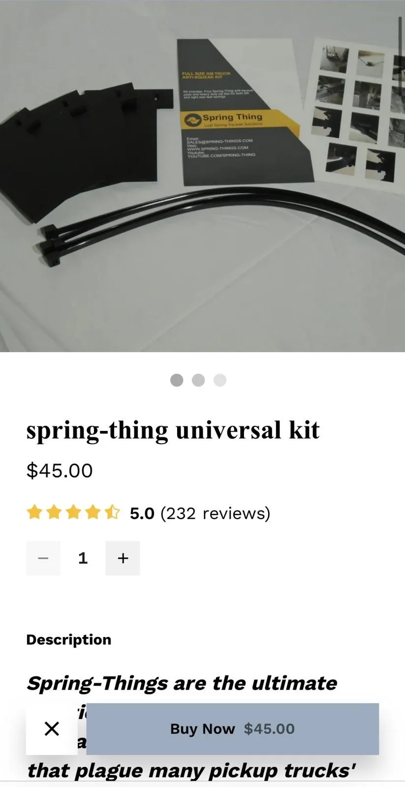

I just addressed the same issue. The knocking and clunking started in & out of driveway, then got progressively worse. Dealer greased leaf springs and tightened everything up… lasted 2 days… came back. Had leaf springs replaced under warranty… lasted maybe 2 days, then started up again. Was driving me nuts.
Resolved issue using “Spring-Thing” (link below). Very common problem with multiple models. Best $56.55 I ever spent.
When leveling truck, I had mechanic install the rubber pads between top 2 leaf springs. Took him 10-15 min tops. I haven’t had an issue since.

well done! excellent info.
