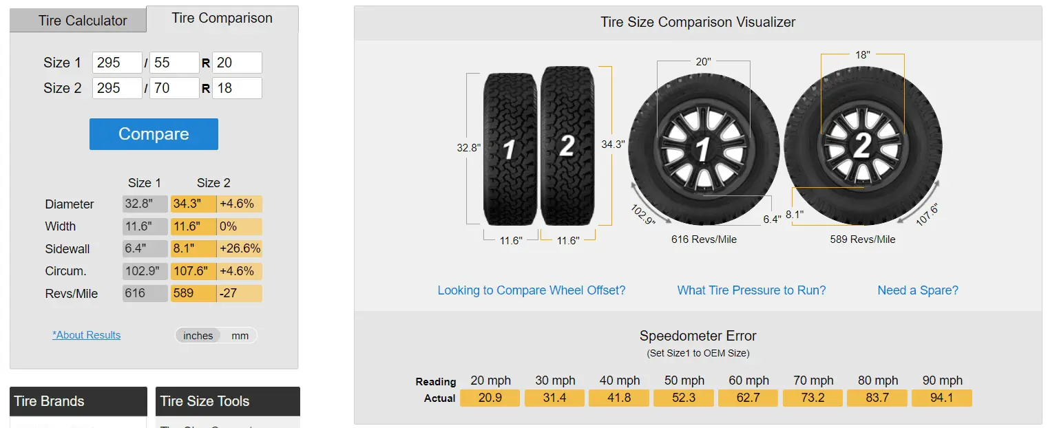

That's a good looking ride you have there! Unfortunately the 295/70 R18 is 1.5" taller than the 295/55 R20. Does it look like there is 0.75" of clearance at full lock?
