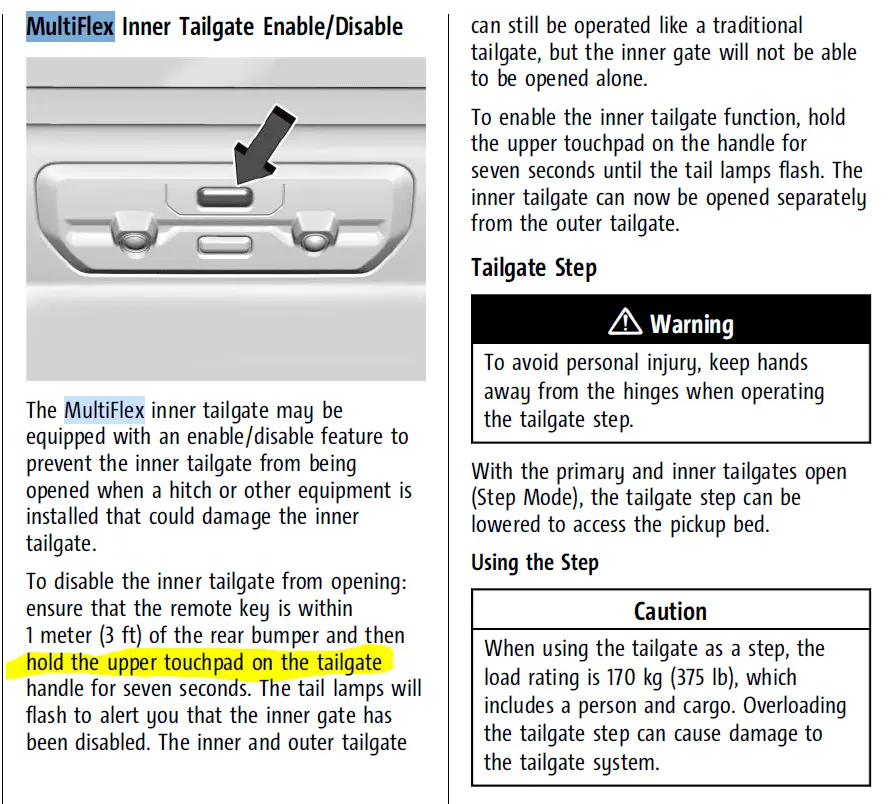

QUESTION: Is the inner tailgate supposed to open with a single push of the button? I press mine and hear a click, but it won't open unless I press the button a second time. I assume this isn't normal?

It might be in lock mode or confused. Hold the button down for several seconds to lock, taillights will flash. Hold it down for several seconds to unlock. Then trry it again to see if it's back to a normal cycle.

Another feature not mentioned to much is if you hold both buttons same time till taillights flash. It will deactivate top section so you can’t accidentally drop it out into trailer ball/hitch . Reverse pressing both buttons till tail lights flash to reactivate top again 😀
Actually it is just the top button, it may work if you hold both buttons, but the top one is the one that does the work, per the manual, and per my experience using this feature often.
Thanks for update. I went out and tried it and works as described. Silly salesman had me wasting a extra finger 🤪
